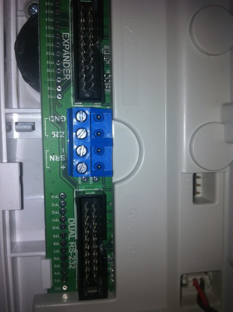

solo Posted September 16, 2013 Share Posted September 16, 2013 Hi People.I bought a Visonic powermax complete about two years ago but never installed it. Anyway my current 20 year old alarm (optima xm) is playing up so decided to try out the Visonic. I have powered it up used a 3amp fused spur, everything looks straight forwardish as regards to programming.One question, everywhere i have read it states that a wireless bell box has to be used or a expander module needs to be fitted to use a wired bell box.Can someone please tell me what the picture is showing, am i wrong to think this is for the bell box?The blue connection point, you can see "SRN"? what is this for? Would appreciate the help. Link to comment https://www.thesecurityinstaller.co.uk/community/topic/35320-visonic-powerax-complete/ Share on other sites More sharing options...
datadiffusion Posted September 17, 2013 Share Posted September 17, 2013 I'm assuming this would be for a simple, untampered speaker (although you could use the adjacent zone I suppose) or a simple internal siren; a traditional outside bellbox will be a SAB and I'm making a rough guess these terminals will not provide for that. So looks like you will need the module. All just a guess though, I'm sure an expert will be along in a mo. So, I've decided to take my work back underground.... to stop it falling into the wrong hands Link to comment https://www.thesecurityinstaller.co.uk/community/topic/35320-visonic-powerax-complete/#findComment-345240 Share on other sites More sharing options...
sixwheeledbeast Posted September 17, 2013 Share Posted September 17, 2013 This is to drive a internal sounder only. Powermax Complete doesn't support a "proper" wired bellbox without the output module. Link to comment https://www.thesecurityinstaller.co.uk/community/topic/35320-visonic-powerax-complete/#findComment-345252 Share on other sites More sharing options...
