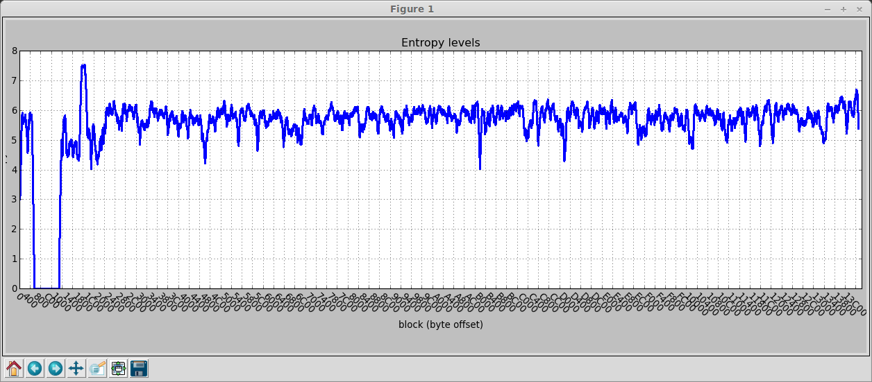

cybergibbons Posted June 26, 2013 Author Share Posted June 26, 2013 Thanks for the input. The EN50131 is really quite a clear standard. EN50136 is really heavy going in comparison, it might be my lack of familiarity with all the terminology. A quick correct to the above - my conversion from Intel HEX to binary was incorrect, and looking at it, there is a chunk of very high entropy which would indicate some kind of key material. Anyway, lots of stuff to get on with/ I have a blog, some of which is about alarm security and reverse engineering:http://cybergibbons.com/ Link to comment https://www.thesecurityinstaller.co.uk/community/topic/34850-hi-res-picture-of-csl-dualcom-unit/page/2/#findComment-329968 Share on other sites More sharing options...
