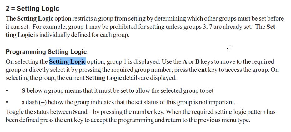

timmo66 Posted May 29, 2013 Share Posted May 29, 2013 Will setting logics not do the job? Link to comment https://www.thesecurityinstaller.co.uk/community/topic/34655-setting-up-groups-on-a-gd96/page/2/#findComment-324419 Share on other sites More sharing options...
matthew.brough Posted May 29, 2013 Share Posted May 29, 2013 Will setting logics not do the job? Setting logic only prevents setting based on the set/unset status of other groups. www.securitywarehouse.co.uk/catalog/ Link to comment https://www.thesecurityinstaller.co.uk/community/topic/34655-setting-up-groups-on-a-gd96/page/2/#findComment-324422 Share on other sites More sharing options...
timmo66 Posted May 29, 2013 Share Posted May 29, 2013 It will set a group automatically when a certain other group is set, and therefore unset automatically when that certain group is unset. Correct me if I am wrong. Is this what the OP is after? Link to comment https://www.thesecurityinstaller.co.uk/community/topic/34655-setting-up-groups-on-a-gd96/page/2/#findComment-324429 Share on other sites More sharing options...
matthew.brough Posted May 29, 2013 Share Posted May 29, 2013 It will set a group automatically when a certain other group is set, and therefore unset automatically when that certain group is unset. Correct me if I am wrong. Is this what the OP is after? The setting logic feature doesn't work in this way AFAIK. You could do this with links and relays but according to the book it only controls people manually setting the system and preventing you from doing so if certain conditions aren't met. Don't use the feature in the wild so only know what I've read in the engineer guide. www.securitywarehouse.co.uk/catalog/ Link to comment https://www.thesecurityinstaller.co.uk/community/topic/34655-setting-up-groups-on-a-gd96/page/2/#findComment-324433 Share on other sites More sharing options...
timmo66 Posted May 29, 2013 Share Posted May 29, 2013 I have used setting logic in buildings with common areas. For example group 8 is common areas, and will set automatically when 1 2 3 4 5 6 7 are set. You then enter the property via the common area and unset whatever area you want, which then automatically unsets group 8 too. Link to comment https://www.thesecurityinstaller.co.uk/community/topic/34655-setting-up-groups-on-a-gd96/page/2/#findComment-324460 Share on other sites More sharing options...
matthew.brough Posted May 29, 2013 Share Posted May 29, 2013 I suppose you could use the vipers in a common area. That might be an easier way. Not sure if that would work with just 1 group. Ill have a play around with my test rig. Only ever done common areas with 2+groups Be interesting to know. www.securitywarehouse.co.uk/catalog/ Link to comment https://www.thesecurityinstaller.co.uk/community/topic/34655-setting-up-groups-on-a-gd96/page/2/#findComment-324461 Share on other sites More sharing options...
