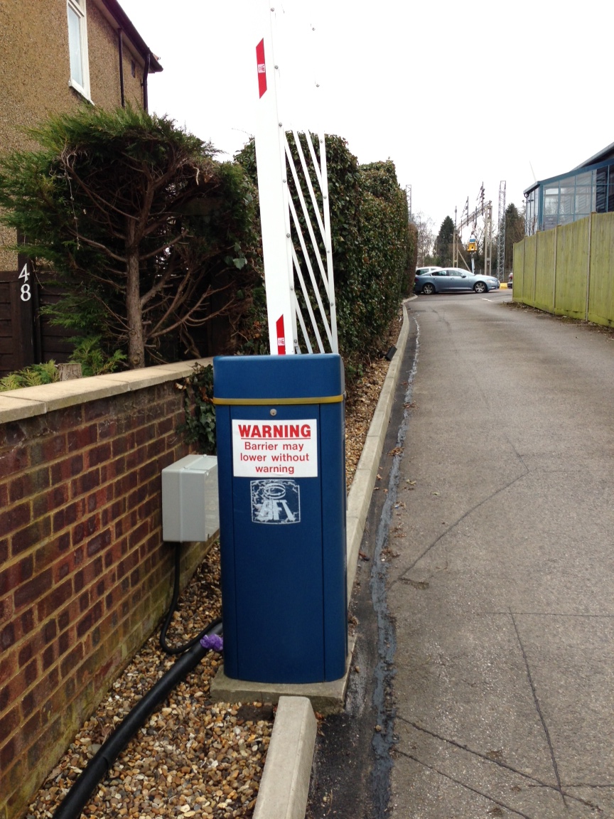

richardthatcher Posted March 25, 2013 Share Posted March 25, 2013 Not really access control well it is a barrier to prevent access. I have taken a picture and have emailed BFT 3 days ago with no response yet. Need to know what model this is so I can get a manual for it and also if serviceable parts are still available. Link to comment https://www.thesecurityinstaller.co.uk/community/topic/34264-need-help-with-this/ Share on other sites More sharing options...

richardthatcher Posted March 25, 2013 Author Share Posted March 25, 2013 picture Link to comment https://www.thesecurityinstaller.co.uk/community/topic/34264-need-help-with-this/#findComment-310562 Share on other sites More sharing options...
PSE Posted March 25, 2013 Share Posted March 25, 2013 BFT Michaelangelo Barrier 24v Motor, Libra C.MV Control Panel. Up to 8 metre openings, For heavier duty cycle Link to comment https://www.thesecurityinstaller.co.uk/community/topic/34264-need-help-with-this/#findComment-310568 Share on other sites More sharing options...

PSE Posted March 25, 2013 Share Posted March 25, 2013 Parts are still available for it, I have attached the manual for you Are all the products named after Ninja Turtles ? Well, I aint come across a Donatello remote yet, or a Raphael controller.... D811528 00100_01.pdf Link to comment https://www.thesecurityinstaller.co.uk/community/topic/34264-need-help-with-this/#findComment-310570 Share on other sites More sharing options...
