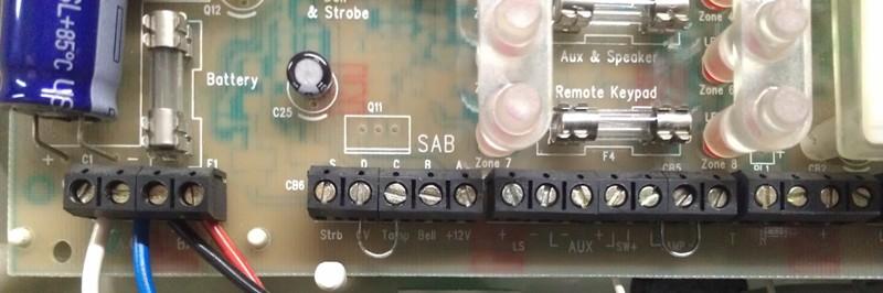

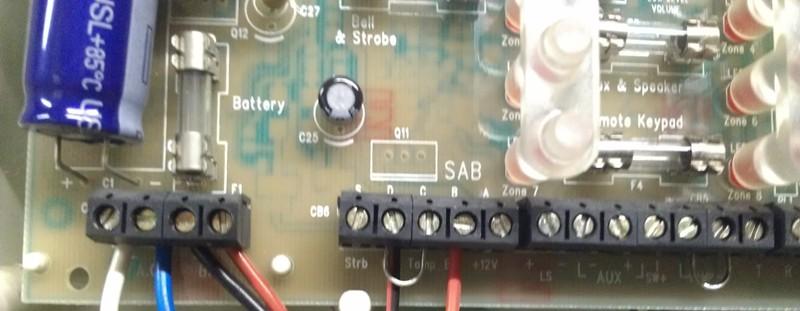

g4m8l3r Posted February 21, 2013 Author Share Posted February 21, 2013 Ok. You have neither SAB or SCB in that case. You just have a 12v siren. Alarms normally switch the negative to the siren, not the positive so this should be a simple case of connecting the red wire to the +12v supply of the panel and wiring the black wire to the bell trigger terminal and that it, there are no other connections to do. That makes sense. Try just connecting 1 of the sirens to start with and see if that works as you would expect. If so connect the second and re-test. still no joy, I have added a picture of the panel with just the tamper loops and power connected and then a picture with the siren connected, the siren is very quiet when connected like this, but when I pop it onto the hard +/- its at full volume again, I just dont understand whats wrong. Link to comment https://www.thesecurityinstaller.co.uk/community/topic/34112-texecom-veritas-8-alarm-panel-help/page/4/#findComment-306685 Share on other sites More sharing options...
matthew.brough Posted February 21, 2013 Share Posted February 21, 2013 Red wire should be in +12v and black should be in Bell. Leaving the link between 0v and tamp, there should be no wires from your siren in Strb, 0v or tamp. The bell output switches negative so in effect you are putting with the wiring above 2 negatives to the sounder, not a positive and a negative. www.securitywarehouse.co.uk/catalog/ Link to comment https://www.thesecurityinstaller.co.uk/community/topic/34112-texecom-veritas-8-alarm-panel-help/page/4/#findComment-306688 Share on other sites More sharing options...
g4m8l3r Posted February 21, 2013 Author Share Posted February 21, 2013 Red wire should be in +12v and black should be in Bell. Leaving the link between 0v and tamp, there should be no wires from your siren in Strb, 0v or tamp. when i connect the red wire to 12v+ and black in bell the siren sounds instantly but when i press the pa it turns off, its as if its working backwards Link to comment https://www.thesecurityinstaller.co.uk/community/topic/34112-texecom-veritas-8-alarm-panel-help/page/4/#findComment-306691 Share on other sites More sharing options...
james.wilson Posted February 21, 2013 Share Posted February 21, 2013 its programmed for scb mode then in the panel you need to invert that securitywarehouse Security Supplies from Security Warehouse Trade Members please contact us for your TSI vetted trade discount. Link to comment https://www.thesecurityinstaller.co.uk/community/topic/34112-texecom-veritas-8-alarm-panel-help/page/4/#findComment-306692 Share on other sites More sharing options...
g4m8l3r Posted February 21, 2013 Author Share Posted February 21, 2013 its programmed for scb mode then in the panel you need to invert that so I need to programme it for SAB ? Link to comment https://www.thesecurityinstaller.co.uk/community/topic/34112-texecom-veritas-8-alarm-panel-help/page/4/#findComment-306693 Share on other sites More sharing options...
