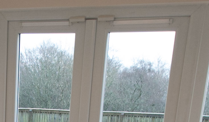

james.wilson Posted November 5, 2013 Share Posted November 5, 2013 the portal supports as many zones as the panel supports, the old rf-rio was 8 zones but could do more. all you need is a g2-20 and a portal. But iirc early domonial sensors wouldnt work with a portal. can you upload a picture of a sensor securitywarehouse Security Supplies from Security Warehouse Trade Members please contact us for your TSI vetted trade discount. Link to comment https://www.thesecurityinstaller.co.uk/community/topic/33735-honeywell-domonial-inherited-as-new-home-owners-help/page/7/#findComment-353105 Share on other sites More sharing options...
mps-property Posted November 5, 2013 Share Posted November 5, 2013 Many thanks for confirming James, thats what I suspected. See attachments, apologies for the low resolution, zoomed into my rental marketing photos. Link to comment https://www.thesecurityinstaller.co.uk/community/topic/33735-honeywell-domonial-inherited-as-new-home-owners-help/page/7/#findComment-353106 Share on other sites More sharing options...
mps-property Posted November 5, 2013 Share Posted November 5, 2013 For some reason this forum is saying I am not authorised to view attachments. Trying again, if same for others. http://i42.tinypic.com/292sidv.jpg http://i42.tinypic.com/202w3k.jpg Link to comment https://www.thesecurityinstaller.co.uk/community/topic/33735-honeywell-domonial-inherited-as-new-home-owners-help/page/7/#findComment-353107 Share on other sites More sharing options...
james.wilson Posted November 5, 2013 Share Posted November 5, 2013 you need 5 posts to be able to download stuff. But that looks like the newer sensor so should be fine securitywarehouse Security Supplies from Security Warehouse Trade Members please contact us for your TSI vetted trade discount. Link to comment https://www.thesecurityinstaller.co.uk/community/topic/33735-honeywell-domonial-inherited-as-new-home-owners-help/page/7/#findComment-353109 Share on other sites More sharing options...
