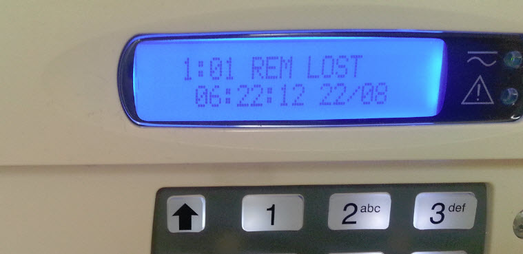

mandem Posted September 16, 2012 Share Posted September 16, 2012 Hi All, Need some assistance its been bugging me for months, but cant find a fix, im going mad. i keep getting "1:01 REM LOST" see attached. It seems to happen at least once a fortnight, once i reset it using the engineer code works fine for a couple of days, maybe even a week. I think it means the remote keypad is lost, but im not sure which one. I checked both the keypads the wires look securely connected. Any ideas how i should troubleshoot? or what I should do? Setup below Manvier M800 8-40 Zone Grade 3 Alarm panel. (installed in 2008) Manvier MSNODE8 Zone Expander (installed in 2008) 2 x Menvier MKP 3 (replaced both keypads in oct 2011, as both had a faulty LCD display, missing letters of text) Thanks M Link to comment https://www.thesecurityinstaller.co.uk/community/topic/33413-manvier-m800-keeps-going-off-rem-lost/ Share on other sites More sharing options...
sixwheeledbeast Posted September 16, 2012 Share Posted September 16, 2012 Seems to be Keypad number 1 going missing. Swapping the two keypads with the opposite location would be my first thing to try. Also testing the voltage at the keypad would be a good idea. Link to comment https://www.thesecurityinstaller.co.uk/community/topic/33413-manvier-m800-keeps-going-off-rem-lost/#findComment-290345 Share on other sites More sharing options...

Oxo Posted September 16, 2012 Share Posted September 16, 2012 ABCD being the important connections, E is just the speaker driver. AB are power CD are data. You will also need to do a relearn when you swap out to be on the safe side. I assume you have the engineer code and a manual. Link to comment https://www.thesecurityinstaller.co.uk/community/topic/33413-manvier-m800-keeps-going-off-rem-lost/#findComment-290349 Share on other sites More sharing options...
sixwheeledbeast Posted September 16, 2012 Share Posted September 16, 2012 ABCD being the important connections, E is just the speaker driver. AB are power CD are data. You will also need to do a relearn when you swap out to be on the safe side. I assume you have the engineer code and a manual. Sorry. I thought you knew menvier stuff AB = Power CE = Data D = Speaker Link to comment https://www.thesecurityinstaller.co.uk/community/topic/33413-manvier-m800-keeps-going-off-rem-lost/#findComment-290350 Share on other sites More sharing options...
Oxo Posted September 16, 2012 Share Posted September 16, 2012 Been a while, stick one in front of me and it will come back. But its one of the two as you can run a RKP on 4 wire. And the newer ones went from B to SPK anyway. And a relearn will still be needed. Link to comment https://www.thesecurityinstaller.co.uk/community/topic/33413-manvier-m800-keeps-going-off-rem-lost/#findComment-290363 Share on other sites More sharing options...
mandem Posted September 16, 2012 Author Share Posted September 16, 2012 Thanks, didn’t know which was power and data. Yeah i got the engineer codes and manual. I programmed the wards and stuff originally but followed the manual. I’m a bit confused what you mean by relearn? last time i replaced the keypad it picked it up itself. just have to use the engineer code to reset, all the configuration was there. Do i need to do a factory reset? Is there anything i need to do? Thanks Link to comment https://www.thesecurityinstaller.co.uk/community/topic/33413-manvier-m800-keeps-going-off-rem-lost/#findComment-290420 Share on other sites More sharing options...
fozzies Posted September 16, 2012 Share Posted September 16, 2012 Theres an engineering menu option, relearn, think its in menu 2?? , u need to do it Link to comment https://www.thesecurityinstaller.co.uk/community/topic/33413-manvier-m800-keeps-going-off-rem-lost/#findComment-290424 Share on other sites More sharing options...
norman Posted September 16, 2012 Share Posted September 16, 2012 The fault may be because you did not learn the new RKP. Nothing is foolproof to a sufficiently talented fool. Link to comment https://www.thesecurityinstaller.co.uk/community/topic/33413-manvier-m800-keeps-going-off-rem-lost/#findComment-290428 Share on other sites More sharing options...
mandem Posted September 17, 2012 Author Share Posted September 17, 2012 Thanks your right, found it in the manual, engineer menu 2-7-3-3 confirming the network devices. I can check the health status there too. I will give this a go, thanks again for all your help. Link to comment https://www.thesecurityinstaller.co.uk/community/topic/33413-manvier-m800-keeps-going-off-rem-lost/#findComment-290434 Share on other sites More sharing options...
