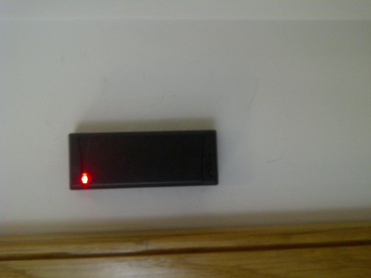

james.wilson Posted July 24, 2012 Share Posted July 24, 2012 Any ideas. ADT standalone system by the looks. just want to know if i can reuse the readers securitywarehouse Security Supplies from Security Warehouse Trade Members please contact us for your TSI vetted trade discount. Link to comment https://www.thesecurityinstaller.co.uk/community/topic/33181-identify-the-reader/ Share on other sites More sharing options...
PeterJames Posted July 24, 2012 Share Posted July 24, 2012 Kantech ioprox It can be used in weigand Does this help? Datasheet.pdf Link to comment https://www.thesecurityinstaller.co.uk/community/topic/33181-identify-the-reader/#findComment-286330 Share on other sites More sharing options...
james.wilson Posted July 24, 2012 Author Share Posted July 24, 2012 ive found that out from when you said it was kantech on the phone earlier. But it appears the smaller (ie this one) is either wiegand or their own protocol. Im guessing they are wiegand ones. Or is there a jumper etc that sets the mode. If i can use them id prefer due to decor. Plus there is 27 of them securitywarehouse Security Supplies from Security Warehouse Trade Members please contact us for your TSI vetted trade discount. Link to comment https://www.thesecurityinstaller.co.uk/community/topic/33181-identify-the-reader/#findComment-286331 Share on other sites More sharing options...
PeterJames Posted July 24, 2012 Share Posted July 24, 2012 The readers have clock and data I am pretty sure, I can ask my mate but he is pretty incoherent at the moment due to Ramadam and the heat According to Kantech they are xsf format or 26bit weigand http://www.acornfiresecurity.com/kantechsa600eniopassstandalonedoorcontroller-4901.php are they connected to these? Link to comment https://www.thesecurityinstaller.co.uk/community/topic/33181-identify-the-reader/#findComment-286334 Share on other sites More sharing options...
james.wilson Posted July 24, 2012 Author Share Posted July 24, 2012 yes they are. Im looking to put in videx or act. Other quotes are paxton based... all of em looking at that link pete my other thread ie fire panel shows its a minerva. pal securitywarehouse Security Supplies from Security Warehouse Trade Members please contact us for your TSI vetted trade discount. Link to comment https://www.thesecurityinstaller.co.uk/community/topic/33181-identify-the-reader/#findComment-286336 Share on other sites More sharing options...
