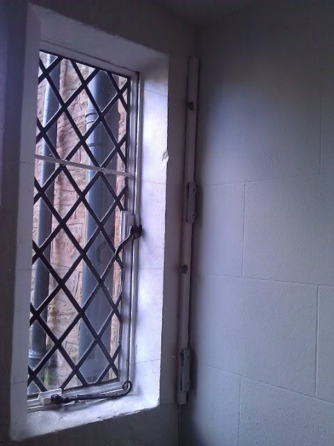

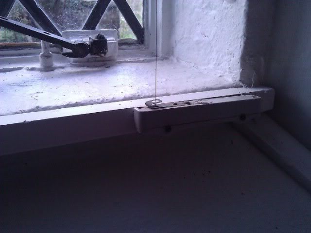

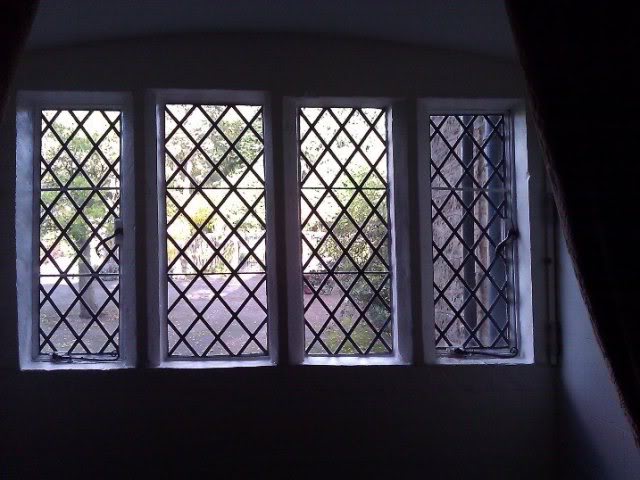

9651 Posted November 1, 2011 Share Posted November 1, 2011 As you all like a pic, I thought I'd show you these Dont see this set up too often (its the only job we do with them fitted......) Close up of the switch mechanism, Clever in how it works, bit of an **** to get them happy. There is a switch in each connection unit. Needs to be tensioned up between two contacts, so if wire cut, switch makes one way, if the wore is stretched it pulls the switch the other way, or if bent the wire touches the metal contact you can see above! They go through an analyser type unit, which then connects to the panel. Its a Gal 60 now, but it started off as a Group 4 alarm back in the mid 70's! (which i suspect these wires are!) Probably one for arf? Anyone worked on/fitted similar??! Link to comment https://www.thesecurityinstaller.co.uk/community/topic/32194-one-for-the-old-school-crew/ Share on other sites More sharing options...

modernjim Posted November 1, 2011 Share Posted November 1, 2011 Up to last year had calls to a working system with this wiring[securifon] i think it was called Link to comment https://www.thesecurityinstaller.co.uk/community/topic/32194-one-for-the-old-school-crew/#findComment-278263 Share on other sites More sharing options...
9651 Posted November 2, 2011 Author Share Posted November 2, 2011 Interesting, it was down as 'piano/window wire' on the zone lists lol! Link to comment https://www.thesecurityinstaller.co.uk/community/topic/32194-one-for-the-old-school-crew/#findComment-278283 Share on other sites More sharing options...
