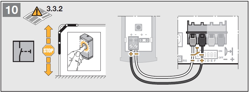

zurrieq Posted March 10, 2011 Author Share Posted March 10, 2011 That relay will be fine for the Latch Key but you may need a heavier duty relay for the garage door. Why? I have a remote controlled garage door. The garage door has a +ve and -ve feed which i connect to a bell-type switch through cat5. When i use the switch the + and - form a circuit which opens or closes the garage depending on what is the next task. If I connect the relay to this mechanism in parallel, it should work... no? Link to comment https://www.thesecurityinstaller.co.uk/community/topic/31165-texecom-speech-dialler/page/2/#findComment-271022 Share on other sites More sharing options...
sixwheeledbeast Posted March 10, 2011 Share Posted March 10, 2011 Why? I have a remote controlled garage door. The garage door has a +ve and -ve feed which i connect to a bell-type switch through cat5. When i use the switch the + and - form a circuit which opens or closes the garage depending on what is the next task. If I connect the relay to this mechanism in parallel, it should work... no? In that case maybe not, some may. I can't see it being a positive and negative feed, more a positive and switched positive. Parallel - if your bell-push is a normally open switch going closed. Link to comment https://www.thesecurityinstaller.co.uk/community/topic/31165-texecom-speech-dialler/page/2/#findComment-271023 Share on other sites More sharing options...
zurrieq Posted March 10, 2011 Author Share Posted March 10, 2011 In that case maybe not, some may. I can't see it being a positive and negative feed, more a positive and switched positive. Parallel - if your bell-push is a normally open switch going closed. See here: Link to comment https://www.thesecurityinstaller.co.uk/community/topic/31165-texecom-speech-dialler/page/2/#findComment-271027 Share on other sites More sharing options...
sixwheeledbeast Posted March 10, 2011 Share Posted March 10, 2011 See here: It says "Bedford" on the buses but they don't all go there! Link to comment https://www.thesecurityinstaller.co.uk/community/topic/31165-texecom-speech-dialler/page/2/#findComment-271028 Share on other sites More sharing options...
zurrieq Posted March 11, 2011 Author Share Posted March 11, 2011 It says "Bedford" on the buses but they don't all go there! hehe true... the diagram shows a normal switch on the left and the supply from the operator. I will connect the relay to the operator as the diagram shows with the stich and that should do the trick. Link to comment https://www.thesecurityinstaller.co.uk/community/topic/31165-texecom-speech-dialler/page/2/#findComment-271064 Share on other sites More sharing options...
