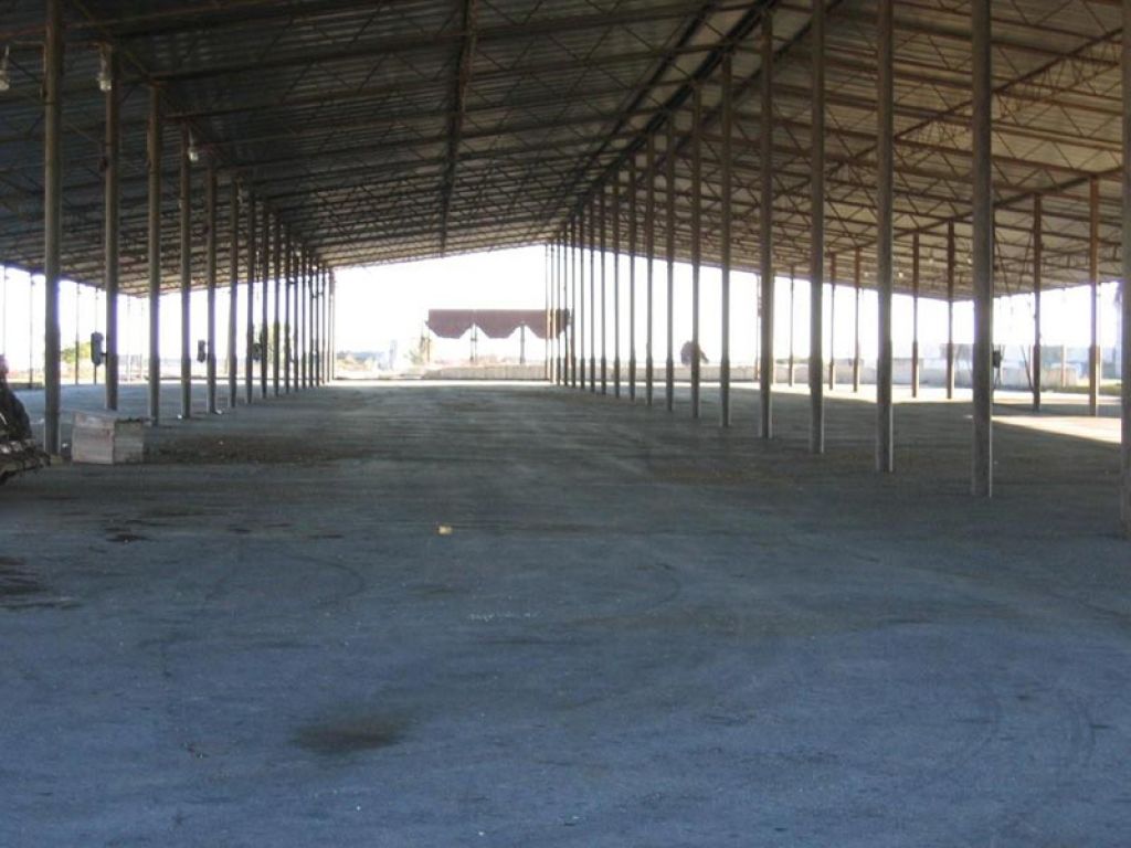

aleksandras1234 Posted May 18, 2009 Share Posted May 18, 2009 Hello, There is store building (see attached foto). An ignitable materials (some kind of maures) will be stored there. Is it required to install fire alarm system in this building due to standards? Thank you. Link to comment https://www.thesecurityinstaller.co.uk/community/topic/28713-fire-alarm-in-store-awning/ Share on other sites More sharing options...

L200 Posted May 18, 2009 Share Posted May 18, 2009 Depends what country we are in , subject to a defined risk assessment as it appears to fairly open to the air a manual system with correct sounders might be enough to satisfy all concerned. Link to comment https://www.thesecurityinstaller.co.uk/community/topic/28713-fire-alarm-in-store-awning/#findComment-237553 Share on other sites More sharing options...
aleksandras1234 Posted May 18, 2009 Author Share Posted May 18, 2009 Thanks for answers. I found, that due to our standards we must instal there fire alarm. Now there is other question: what type of detectors I need to use? a winter temperature about -25 Link to comment https://www.thesecurityinstaller.co.uk/community/topic/28713-fire-alarm-in-store-awning/#findComment-237556 Share on other sites More sharing options...
Guest old-hand Posted May 18, 2009 Share Posted May 18, 2009 Hmmmm Smokes, loads of airborne debris with manure. Heats, Manure does get warm. I`d go for fixed rate heats here personally. (unless someone knows better) Link to comment https://www.thesecurityinstaller.co.uk/community/topic/28713-fire-alarm-in-store-awning/#findComment-237561 Share on other sites More sharing options...
leesutton Posted May 18, 2009 Share Posted May 18, 2009 Id second that but -25 - -30 thats bloody cold.... Â Lee Sutton E-Mail: leesutton@centurianfire.co.uk Website: www.centurianfire.co.uk Phone: 0845 094 9870 CENTURIAN FIRE & SECURITY (part of centurian group limited) Link to comment https://www.thesecurityinstaller.co.uk/community/topic/28713-fire-alarm-in-store-awning/#findComment-237614 Share on other sites More sharing options...
james.wilson Posted May 18, 2009 Share Posted May 18, 2009 i would suggest you probably need to use flame detection, but that may not be relevant to the risk. But as oxo says fixed heats. securitywarehouse Security Supplies from Security Warehouse Trade Members please contact us for your TSI vetted trade discount. Link to comment https://www.thesecurityinstaller.co.uk/community/topic/28713-fire-alarm-in-store-awning/#findComment-237615 Share on other sites More sharing options...
soulstyle Posted May 18, 2009 Share Posted May 18, 2009 I have a similar building to this on our premisis. No automatic detection required, just had to install mcp's with sounders. Hope this helps! Link to comment https://www.thesecurityinstaller.co.uk/community/topic/28713-fire-alarm-in-store-awning/#findComment-237632 Share on other sites More sharing options...
