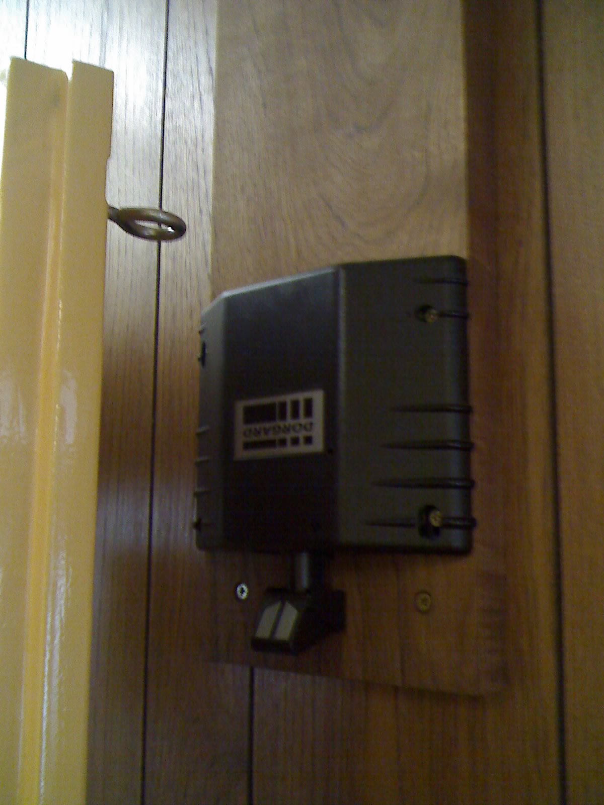

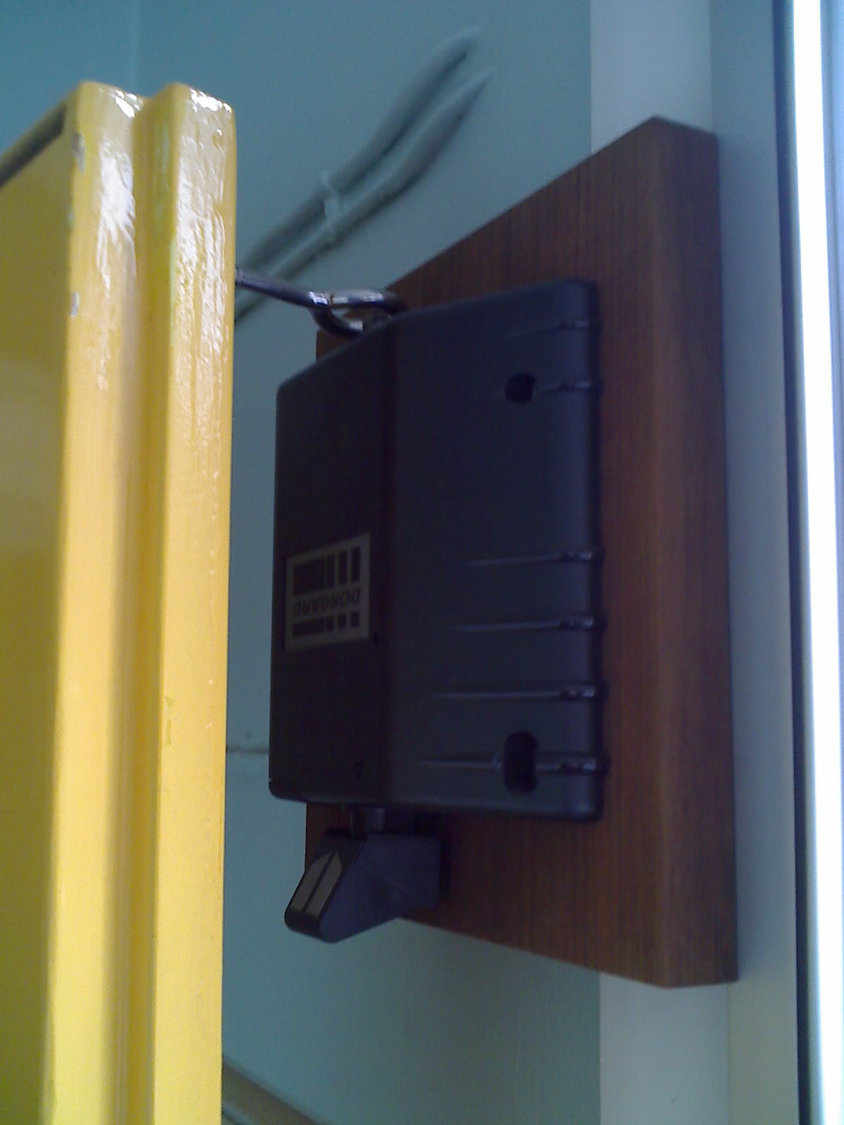

Chorlton Posted May 1, 2009 Share Posted May 1, 2009 unless u use those stupid batt powered things that close on noise. what's your issue with Dorgards Tony? Link to comment https://www.thesecurityinstaller.co.uk/community/topic/26369-mag-locks-for-fire-retaining-doors/page/3/#findComment-235853 Share on other sites More sharing options...

sjsturner Posted May 3, 2009 Share Posted May 3, 2009 what's your issue with Dorgards Tony? sorry chorlton i also have an issue with dorguards there c##p. Everytime you put a hoover on in a hotel/care home all the doors in the hallway start shutting we never fit them but we do look after places that have them its not even like there cheap! Link to comment https://www.thesecurityinstaller.co.uk/community/topic/26369-mag-locks-for-fire-retaining-doors/page/3/#findComment-236037 Share on other sites More sharing options...
james.wilson Posted May 3, 2009 Share Posted May 3, 2009 grantedthey are not as good as wired mags, but IMO better then a wedge that would be used instead securitywarehouse Security Supplies from Security Warehouse Trade Members please contact us for your TSI vetted trade discount. Link to comment https://www.thesecurityinstaller.co.uk/community/topic/26369-mag-locks-for-fire-retaining-doors/page/3/#findComment-236038 Share on other sites More sharing options...
Chorlton Posted May 3, 2009 Share Posted May 3, 2009 Hi sjs no need to apologise fella I'm not personally fussed either way, just nice to know why certain products are disliked. I fit dorgards and like them as there cheap & easy to fit v wiring retainers. the hoover issue is not an issue to me or anyone I've fitted them for but no doubt will be at some point so thanks for the heads up. C. Link to comment https://www.thesecurityinstaller.co.uk/community/topic/26369-mag-locks-for-fire-retaining-doors/page/3/#findComment-236039 Share on other sites More sharing options...
sjsturner Posted May 3, 2009 Share Posted May 3, 2009 fair points. something is better than nothing.Perhaps these places have particulary loud hoovers! Link to comment https://www.thesecurityinstaller.co.uk/community/topic/26369-mag-locks-for-fire-retaining-doors/page/3/#findComment-236043 Share on other sites More sharing options...
hpotter Posted May 5, 2009 Share Posted May 5, 2009 the hoover issue is not an issue to me or anyone I've fitted them for but no doubt will be at some point so thanks for the heads up. Not just the noise with hoovers, also the bashing they give with over zealous cleaners. However, found them fitted to avoid the canning. Also agree, better than a wedge. Link to comment https://www.thesecurityinstaller.co.uk/community/topic/26369-mag-locks-for-fire-retaining-doors/page/3/#findComment-236258 Share on other sites More sharing options...
