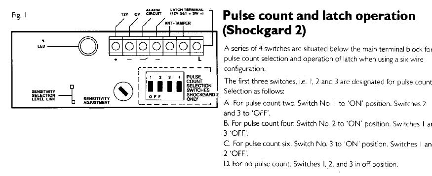

alterEGO Posted September 2, 2007 Share Posted September 2, 2007 Whoops, missed that one, 'pulse count' on shock sensors? sorry mate, but i am the shocker king , does anyone know what they are talking about? yes they do have pulse count, don't think the old sg1's did but have a gander. Link to comment https://www.thesecurityinstaller.co.uk/community/topic/20567-gardtec-816/page/3/#findComment-176834 Share on other sites More sharing options...

oakenholt Posted September 2, 2007 Author Share Posted September 2, 2007 The picture of that board looks identical to the ones on my sensors, and yes Alan I am sure my wiring is 8 core...Mark. Link to comment https://www.thesecurityinstaller.co.uk/community/topic/20567-gardtec-816/page/3/#findComment-176845 Share on other sites More sharing options...

arfur mo Posted September 2, 2007 Share Posted September 2, 2007 The picture of that board looks identical to the ones on my sensors, and yes Alan I am sure my wiring is 8 core...Mark. you can soon tell as it will have brown and orange cores - in assuming alarm cable (not telephone cable) used and they have not been cut off short . i think most 'modern' shocks allow for 1st to alarm feature shown as the 'latch' in AE's posted picture, but to be sure we would need to know what model was used in your home. regs alan If you think education is difficult, try being stupid!!!! Link to comment https://www.thesecurityinstaller.co.uk/community/topic/20567-gardtec-816/page/3/#findComment-176850 Share on other sites More sharing options...
alterEGO Posted September 2, 2007 Share Posted September 2, 2007 you can soon tell as it will have brown and orange cores - in assuming alarm cable (not telephone cable) used and they have not been cut off short .i think most 'modern' shocks allow for 1st to alarm feature shown as the 'latch' in AE's posted picture, but to be sure we would need to know what model was used in your home.regsalanthey will have used the shockgardthink he means its "shocking" that you pulse count the detector ( pun intended )don't think he did mate, i use it when needed. Link to comment https://www.thesecurityinstaller.co.uk/community/topic/20567-gardtec-816/page/3/#findComment-176852 Share on other sites More sharing options...
