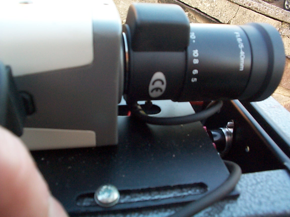

Guest Posted January 11, 2007 Share Posted January 11, 2007 If you can post a picture of the camera body that may help us out. Link to comment https://www.thesecurityinstaller.co.uk/community/topic/14939-auto-iris-lens-control/page/4/#findComment-143296 Share on other sites More sharing options...

sonycamera Posted January 14, 2007 Author Share Posted January 14, 2007 Thanks for that,, you must be reading my small very feeble mind. I think the attachment I posted with the spec on attached ok and I will take the camera down and take a few digital picts on Saturday,,, Thanks Hello again my friends... Well I hope I can manage to attach 6 pictures of the camera and lens.I couldn't get a very good picture of the back of the camera so I have drawn a rough sketch showing what is what. Now if Ihave been taking in half of what you have told me already, I reckon my lens is a video lens and that means my camera setting should be on video and not dc which is what its on at the moment, maybe that all completely wrong ,, but I am trying to understand, Thanks again for taking the trouble. Link to comment https://www.thesecurityinstaller.co.uk/community/topic/14939-auto-iris-lens-control/page/4/#findComment-143852 Share on other sites More sharing options...
james.wilson Posted January 14, 2007 Share Posted January 14, 2007 I dont recodnise the cam but think its a cheapy one. If your using a dd lens then you need to adjust the level pot to stop the faces whiting out. i would alos ensure both your dip switches are off securitywarehouse Security Supplies from Security Warehouse Trade Members please contact us for your TSI vetted trade discount. Link to comment https://www.thesecurityinstaller.co.uk/community/topic/14939-auto-iris-lens-control/page/4/#findComment-143865 Share on other sites More sharing options...

sonycamera Posted January 14, 2007 Author Share Posted January 14, 2007 Not sure how you got to that conclusion?But there are 5 pictures uploaded. Sorry this is the first time I have used this forum,, I can view 3 pics but not sure how I see the other 2 The lens is an Emitec couldn't see any small holes in the side,, strange to me but whilst I was up the ladder i zoomed out from my front gate so that could see more of my drive and the illumination seems a little better with the new lamp in the dennard. So that I have it clear, are we saying that there is nothing I can do to get the cam to see the LED illuminator,, I must admit I didn't hold the LED in front of the camera,, but if you say I need to check that then I will do. Link to comment https://www.thesecurityinstaller.co.uk/community/topic/14939-auto-iris-lens-control/page/4/#findComment-143898 Share on other sites More sharing options...

Guest Posted January 14, 2007 Share Posted January 14, 2007 what a prat I am , I only had to move my screen tab to see the otehr pics,,,,,,,,,,,, lol, I was about to suggest that! Adjust the level pot on the back of the camera, not the lens itself. Link to comment https://www.thesecurityinstaller.co.uk/community/topic/14939-auto-iris-lens-control/page/4/#findComment-143902 Share on other sites More sharing options...
