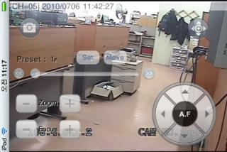

There are also mobile 'apps' allowing live view of any camera and ptz control. The iphone app is on the app store.
