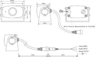

Smart Electrics Posted October 1, 2005 Share Posted October 1, 2005 This is one. I got out of my Catalogue. Link to comment https://www.thesecurityinstaller.co.uk/community/topic/7618-camper-van/#findComment-70526 Share on other sites More sharing options...
daiashthomas Posted October 1, 2005 Author Share Posted October 1, 2005 This is one. I got out of my Catalogue. 70526[/snapback] that looks fairly tidy what sorta size is it as i wouldn't want anything bigger than a tennis ball (rough i know but tennis ball was only thing i could come up with LOL) whats build quality and picture like ? and where could i get one from ? Trade Member Link to comment https://www.thesecurityinstaller.co.uk/community/topic/7618-camper-van/#findComment-70619 Share on other sites More sharing options...
