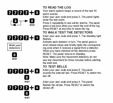

Guest Posted July 6, 2005 Share Posted July 6, 2005 Rich it says in the manual to Press RESET to end test, and it isnt working like that. Link to comment https://www.thesecurityinstaller.co.uk/community/topic/6680-scanny-500/#findComment-59734 Share on other sites More sharing options...
Guest Posted July 6, 2005 Share Posted July 6, 2005 Here is an exert, does sound like incorrect wirring to me though judging by his description. Link to comment https://www.thesecurityinstaller.co.uk/community/topic/6680-scanny-500/#findComment-59736 Share on other sites More sharing options...
