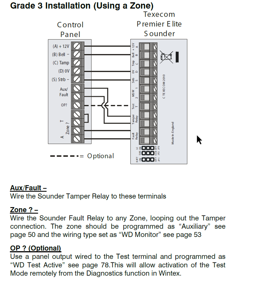

newuwave Posted November 17, 2025 Author Share Posted November 17, 2025 Looking at my notes from 13 years ago I have my boxes wired as this..... But I am not using Aux/Fault to monitor tamper but am doing this.... and I did not use an output to carry out Test I guess because manual cites auto self test every 24 hours. The test input can be used to invoke a remote sounder test, this performs the same functions as the self test which is carried out once every 24 hours. To invoke the test the input must be placed at 0V for a minimum of 60s, during this time the Fault relay will open to signal the test is in progress. On completion of a successful test the Fault relay will close, if the test fails the relay will stay open. I recall 13 years ago it took me quite a few days to digest manuals, install and program the kit as it is quite complicated and hence taken me some time to refresh what I'd done. So today up the ladders I go to change the bell boxes to have some confidence in their reliability ....bit wobbly these days as an OAP approaching 70 so will take it easy. Thanks for the help. Link to comment https://www.thesecurityinstaller.co.uk/community/topic/47410-grade-3-bell-box-monitoring/page/2/#findComment-531284 Share on other sites More sharing options...

newuwave Posted November 17, 2025 Author Share Posted November 17, 2025 Good point about relay. I guess I can bring each test wire back to loft JB and just leave them on oc terminal rail. Log on in Engineer mode to view event log, test leads (reading voltage maybe?) on the relay output connected to terminal rail then test each at a time by linking it to 0V for minimum of 60 seconds with a wire..... I wonder if the relay event is logged ....could use this to see results. Thanks again. Link to comment https://www.thesecurityinstaller.co.uk/community/topic/47410-grade-3-bell-box-monitoring/page/2/#findComment-531287 Share on other sites More sharing options...
