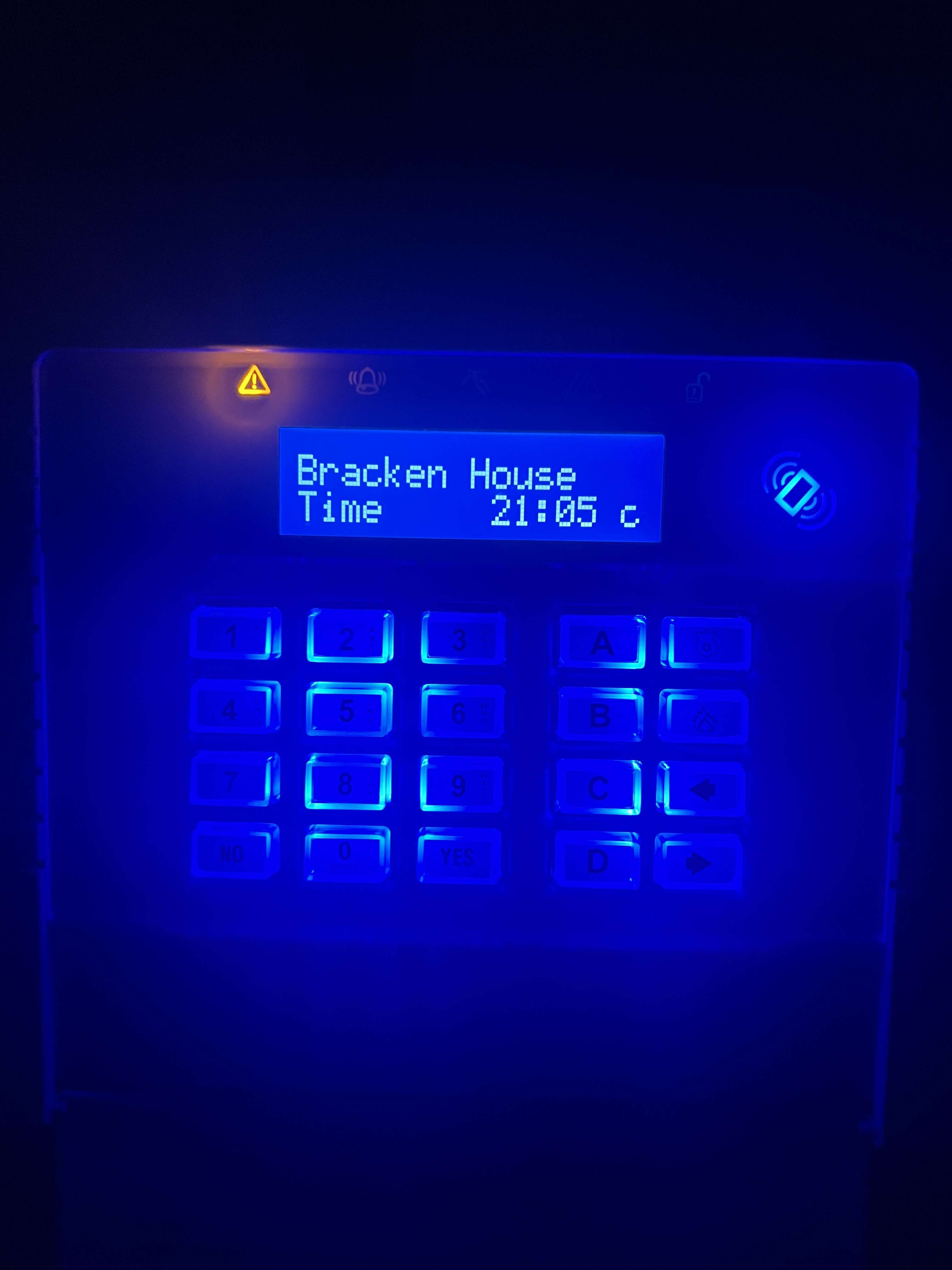

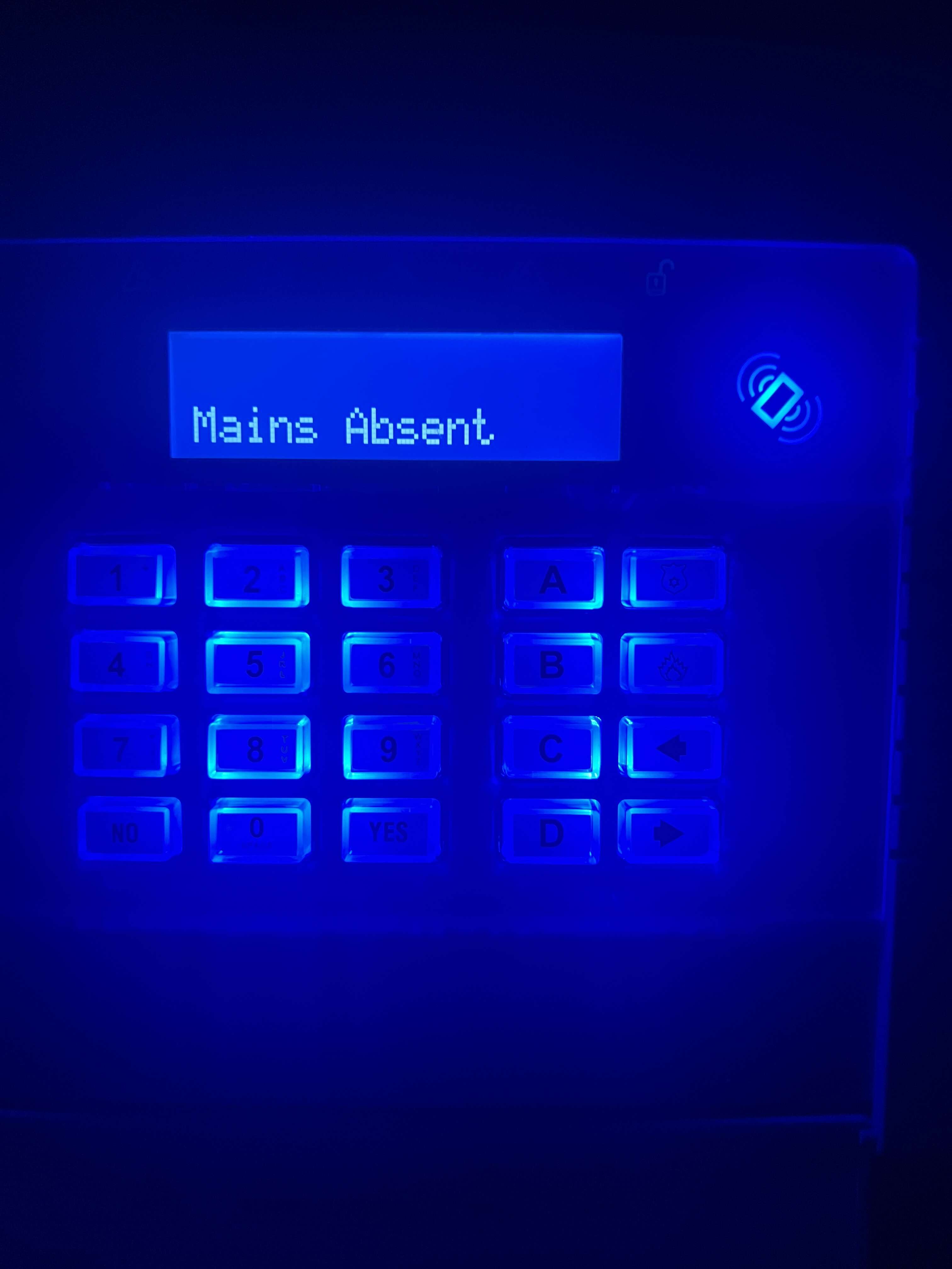

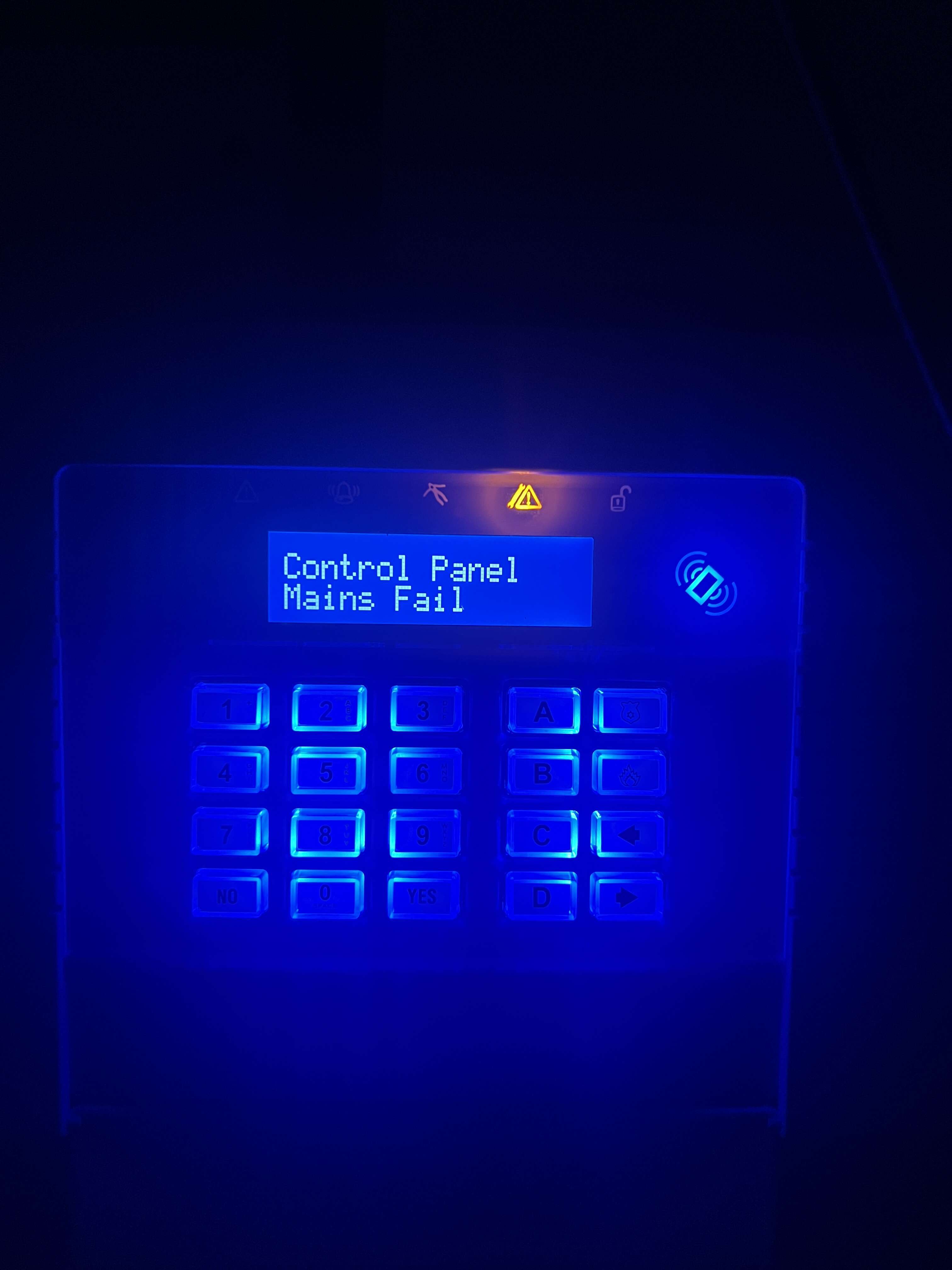

Hugh94 Posted September 28, 2025 Share Posted September 28, 2025 Hi, I don't tend to ask for help on anything fire/security but find myself stuck, I have a pyronix Enforcer panel and it keeps getting a mains absent fault with the first warning light on top of the panel. Then it has shown a control panel - mains fail fault with the 4th light on at the top, I have replaced the panel but still same issue, client got a spark out to run a new cable from the board next to the panel and put in a new spur, checked voltage and power to system, I also checked voltages when there and no drop, 240v at mains/spur side and 13-15v at Stepdown for panel side, anybody ever had this issue? Need this sorted ASAP and it's doing my head in now. Any help would be appreciated, thanks. Link to comment https://www.thesecurityinstaller.co.uk/community/topic/47380-pyronix-enforcer-v10-mains-fail-fault/ Share on other sites More sharing options...

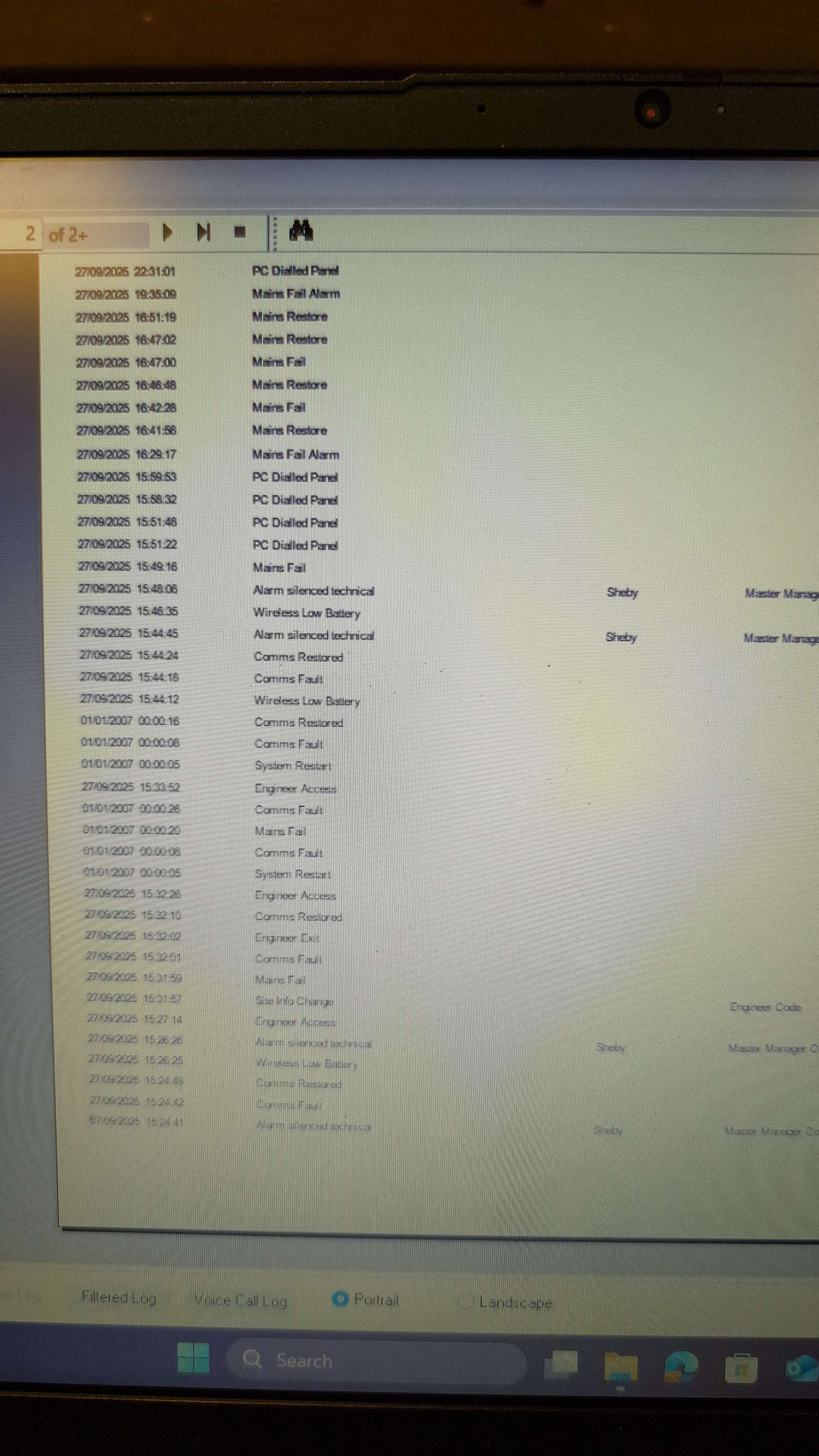

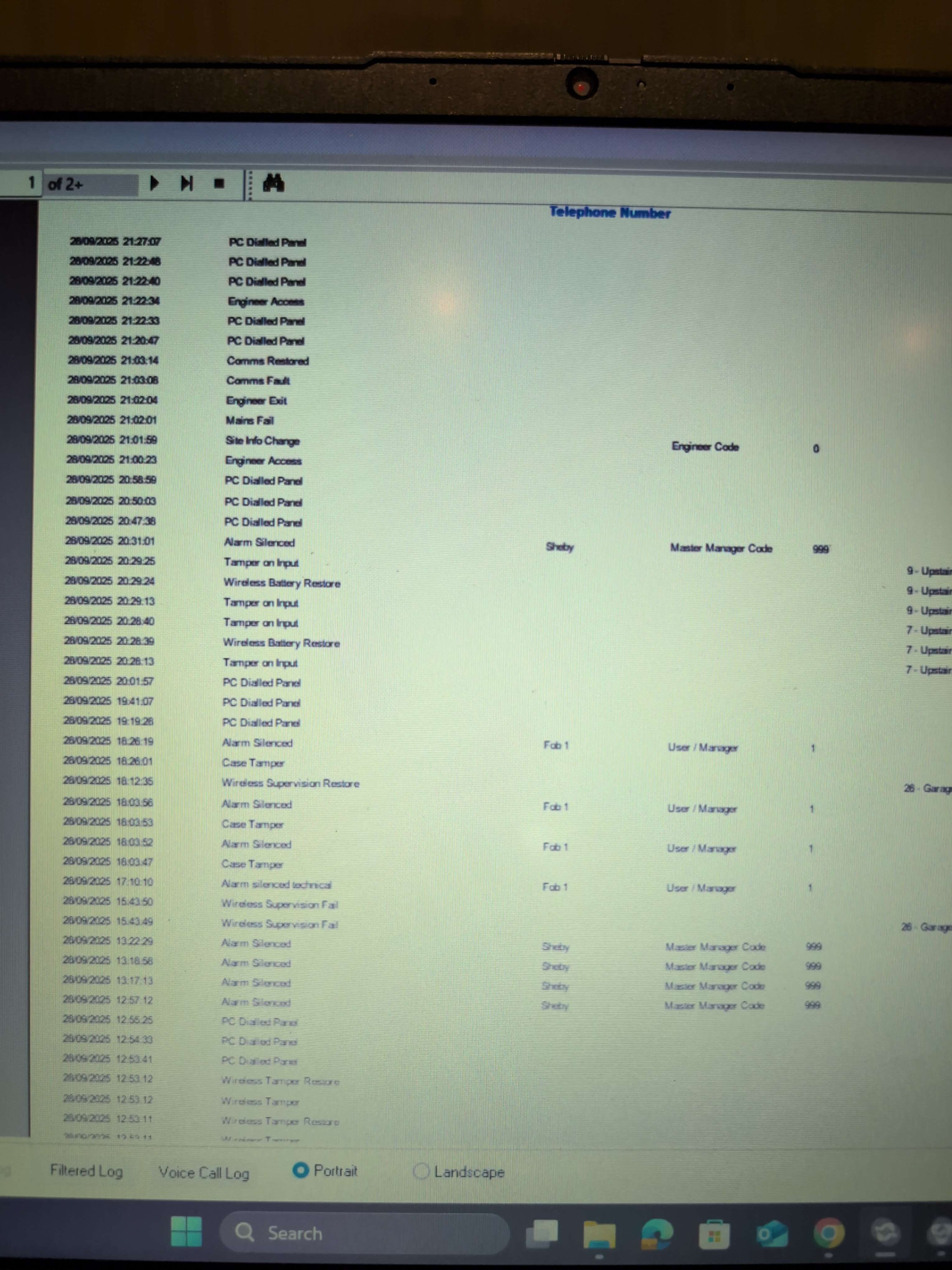

Hugh94 Posted September 29, 2025 Author Share Posted September 29, 2025 1 minute ago, al-yeti said: What does the log show ? Times etc? Shows this, at the time I was away the client said that the panel showed mains absent but wasn't on the log until later when he turned the spur off to test, but it's not there at all Link to comment https://www.thesecurityinstaller.co.uk/community/topic/47380-pyronix-enforcer-v10-mains-fail-fault/#findComment-530886 Share on other sites More sharing options...
al-yeti Posted September 29, 2025 Share Posted September 29, 2025 Is that the only mains fail? Or you made a list? And do you have any kind of voltage logger?for mains Link to comment https://www.thesecurityinstaller.co.uk/community/topic/47380-pyronix-enforcer-v10-mains-fail-fault/#findComment-530887 Share on other sites More sharing options...
