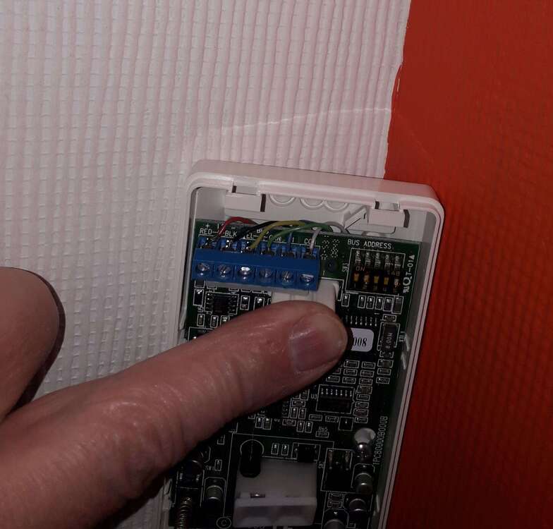

Recently the alarm played up. The alarm triggered when we set it almost immediately. I checked the log with 8 - enter - code and it indicated one faulty zone - actually with the recently changed PIR - and I ordered a new PIR. As the older ones are Risco I ordered a Risco iWISEBus. The PCB is different but I thought it should work....
In the process of changing the PIR I triggered the alarm a few times when wires were touching. Once the new Risco was wired up I could not arm the alarm any more. The panel is showing the tamper LED and when I key in the code I can hear a beep.
I have not opened the main panel yet.
I have attached a picture of the wired in Risco iWISEBus.
Can anyone help please. Why should the alarm start showing the tamper LED constantly after alarms have been triggered?

22 hours ago, james.wilson said:
Isn't the iwise bus a bus detector that will only work on a risco panel?
You have also probably blown the fuse or panel. Wires shouldn't 'touch'
QFA Bus detectors or ID detectors from a different brand will not work
