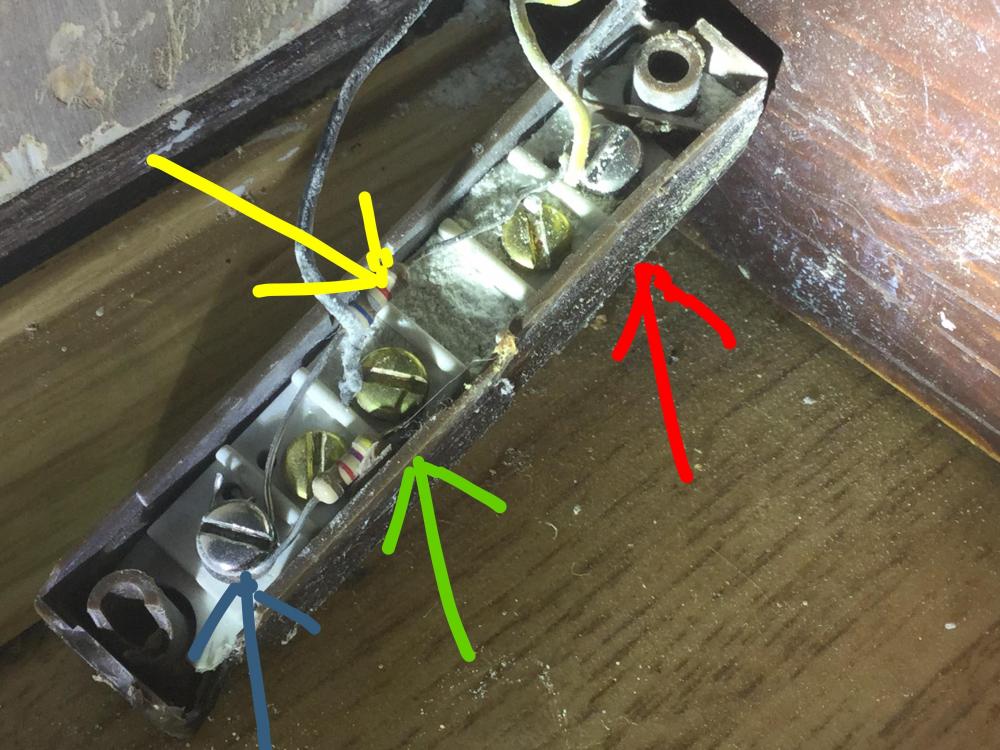

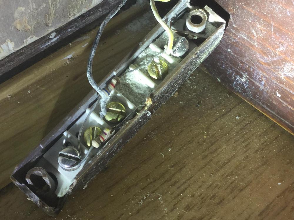

  • swapping the colours around make no difference to the circuit,   your picture shows the strands of the cable touching.... that is probably why it was in tamper

    System will be fine powered up to change the contact.

is it best to power down the system before changing a door reed contact ?

Contact is only a zone and tamper pair and has no device power.
