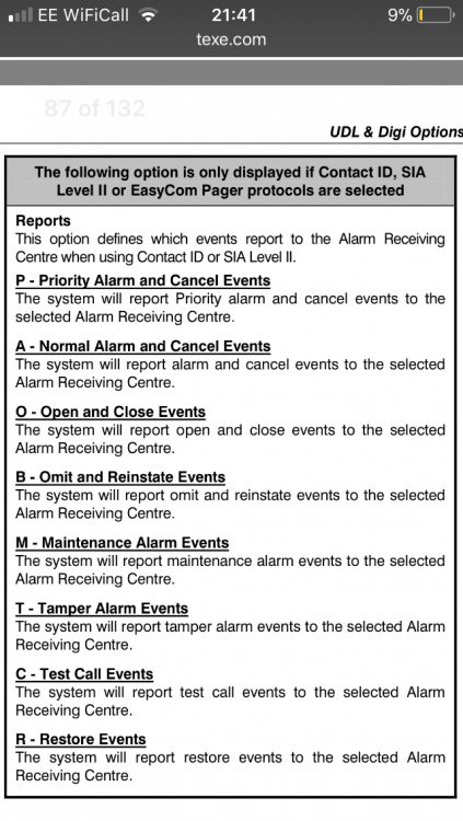

sixwheeledbeast Posted December 9, 2017 Share Posted December 9, 2017 You can select the type of alarms that are notified in the reporting options, open/closed is disabled on default so digis, diallers and tap don't rack up huge bills. I have said this many times before, Texecom menu structure has evolved over a long time and often has many ways to do the same thing. The menus make sense to installers that have used them everyday and definitely aren't irrelevant. Apps for the two popular platforms have to conform to guidelines on battery life, always running in the background would consume the devices battery very quickly. In addition the phones OS generally disables inactive windows if the app is written to use this, which is why you can have loads of things open on your phone an have no issues. The way round this battery issue is the push notifications but even they are one way so no guarantees you will receive the message therefore will never beat proper signalling. Link to comment https://www.thesecurityinstaller.co.uk/community/topic/41796-smartcom/#findComment-472216 Share on other sites More sharing options...
sjsturner Posted December 9, 2017 Share Posted December 9, 2017 (edited) As above ^^ its in “UDL options”, “program Digi” under “Reports” you select and de-select the reporting types from there Edited December 9, 2017 by sjsturner ******* auto correct Link to comment https://www.thesecurityinstaller.co.uk/community/topic/41796-smartcom/#findComment-472217 Share on other sites More sharing options...

sjsturner Posted December 9, 2017 Share Posted December 9, 2017 It will do, it just hasn’t been selected, in the options we referred to earlier... Link to comment https://www.thesecurityinstaller.co.uk/community/topic/41796-smartcom/#findComment-472223 Share on other sites More sharing options...
