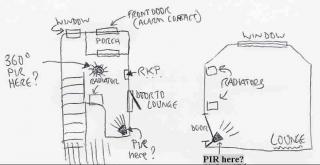

Guest mike2004 Posted October 22, 2004 Share Posted October 22, 2004 In the entrance hallway, I'm trying to decide between 2 possible PIR options: 1) a standard PIR up high, facing the front door i.e. someone entering would walk towards it (there's no suitable place to put it so that someone entering would walk across it) [eg Texecom Prestige-DT or Optex MX] 2) a 360-degrees ceiling mount PIR on the hall ceiling, nearish to the front door (1-2 metres away) [eg Optex FX-360 or Texecom RF-360] Is either option better? Mike Link to comment https://www.thesecurityinstaller.co.uk/community/topic/3962-photos-of-alarm-system-installation/page/5/#findComment-28614 Share on other sites More sharing options...
Guest Posted October 22, 2004 Share Posted October 22, 2004 In the entrance hallway, I'm trying to decide between 2 possible PIR options:1) a standard PIR up high, facing the front door i.e. someone entering would walk towards it (there's no suitable place to put it so that someone entering would walk across it)Â [eg Texecom Prestige-DT or Optex MX] 2) a 360-degrees ceiling mount PIR on the hall ceiling, nearish to the front door (1-2 metres away)Â [eg Optex FX-360 or Texecom RF-360] Is either option better? Mike 28614[/snapback] Are there windows in the door or at the side, if so that rules out option 1 as PIR's shouldn't be facing windows. I usually go for a PIR above the door in the corner set as time inhibit\entry route and use a contact on the door as the entry\exit zone. Link to comment https://www.thesecurityinstaller.co.uk/community/topic/3962-photos-of-alarm-system-installation/page/5/#findComment-28632 Share on other sites More sharing options...
Guest mike2004 Posted October 23, 2004 Share Posted October 23, 2004 Are there windows in the door or at the side, if so that rules out option 1 as PIR's shouldn't be facing windows. The door itself doesn't, though there is a small window next to it. Is the "don't face windows" rule really that definite? What with trying to avoid being above, near or facing radiators, and all the other rules, the sites I've eventually come up with for the lounge and the dining room are in the corners of the rooms, above the doors, facing another corner (near the window). This picture shows the hall and lounge: Any thoughts? Mike Link to comment https://www.thesecurityinstaller.co.uk/community/topic/3962-photos-of-alarm-system-installation/page/5/#findComment-28659 Share on other sites More sharing options...

Guest Posted October 23, 2004 Share Posted October 23, 2004 Lounge - diagonally opposite corner. Hall - other end of the wall, between RKP and door, although if the drawing's to scale(!) you might get away with it where it is. Link to comment https://www.thesecurityinstaller.co.uk/community/topic/3962-photos-of-alarm-system-installation/page/5/#findComment-28675 Share on other sites More sharing options...
