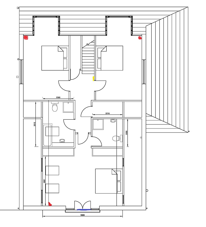

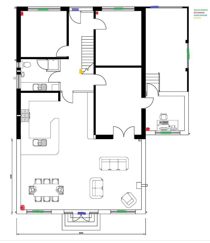

resnikov Posted March 4, 2014 Share Posted March 4, 2014 I was hoping someone might be able to pass comment on my ideas for my home alarm system. The house is currently a shell, so the perfect time to put a system in. I think I have the sensors in the correct locations but still not sure one or two of them. We have 2 cats who when we are not in the house will only be in the downstairs bathroom so for that room not sure weather to go for a pet PIR or just shock sensors on the windows or both. The only entry and exit area I was planning on was the front door but may change later if I get the IP module and use the phone app which would allow me to exit via the garage and then set. Also thinking about putting in Smoke/heat sensors as well. I'm looking at using the Texecom Premier Elite 48 with a few extenders. for all comments Link to comment https://www.thesecurityinstaller.co.uk/community/topic/36261-newbie-alarm-idea-and-plan/ Share on other sites More sharing options...
Rulland Posted March 4, 2014 Share Posted March 4, 2014 In my opinion you've gone over the top, one usually has perimeter protection, ie shocks, or PIR's, to have both doesn't gain much, if the cats are in the bathroom why have any protection in there anyway?, not as if an intruder will break in there and either nick the cats or the toilet only. Only thing to gain possibly by shocks is having the ability to part set if the cats are given further access-even then I'd be wary tbh. I would look at putting a PIR in the hallway though, and possibly moving the location of the LH room PIR to the other side, ie it can't see movement in the hallway and doesn't have to be an access zone if the door was left open. Link to comment https://www.thesecurityinstaller.co.uk/community/topic/36261-newbie-alarm-idea-and-plan/#findComment-370375 Share on other sites More sharing options...
resnikov Posted March 4, 2014 Author Share Posted March 4, 2014 The idea of the shocks was so I can do a perimeter set when in the house and still move about and the full set when out. Where abouts would you put the PIR in the hallway? Link to comment https://www.thesecurityinstaller.co.uk/community/topic/36261-newbie-alarm-idea-and-plan/#findComment-370376 Share on other sites More sharing options...
Rulland Posted March 4, 2014 Share Posted March 4, 2014 Bottom left or top right, no ones going to break through a living room window whilst you are watching telly, they would more likely go for utility rooms or toilets. Perimeter on out of sight less used rooms, and just PIR's in frequently used rooms. Link to comment https://www.thesecurityinstaller.co.uk/community/topic/36261-newbie-alarm-idea-and-plan/#findComment-370377 Share on other sites More sharing options...
Amps Posted March 4, 2014 Share Posted March 4, 2014 Nice layout drawing mate. You do it yourself? If so what software you using? Link to comment https://www.thesecurityinstaller.co.uk/community/topic/36261-newbie-alarm-idea-and-plan/#findComment-370378 Share on other sites More sharing options...

datadiffusion Posted March 4, 2014 Share Posted March 4, 2014 [...] The house is currently a shell, [...] Nice layout drawing mate. You do it yourself? If so what software you using? I suspect, the architect So, I've decided to take my work back underground.... to stop it falling into the wrong hands Link to comment https://www.thesecurityinstaller.co.uk/community/topic/36261-newbie-alarm-idea-and-plan/#findComment-370385 Share on other sites More sharing options...
