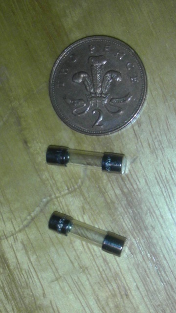

Westindieman Posted December 2, 2013 Author Share Posted December 2, 2013 2 small fuses in that box have gone. What size are they likely to be? I cant read tiny writing. Thanks Link to comment https://www.thesecurityinstaller.co.uk/community/topic/35739-check-low-batt-message/page/2/#findComment-357402 Share on other sites More sharing options...

matthew.brough Posted December 2, 2013 Share Posted December 2, 2013 2 small fuses in that box have gone. What size are they likely to be? I cant read tiny writing. Thanks I'd get a magnifying glass. Could be anything from 0.5a to 2a but are they quick blow, slow blow etc etc. You need to know this hence why the recommedation to get an engineer to make sure it is correct. * Failing that if you're not fussed about it being right and safe sellotape a nail across the terminals which will bypass the fuse entirely and next time a fault develops might start a nice little fire. * Disclaimer. Do not try this at home. A fuse isn't just a fuse and it is vastly important that the correct ones are used. They are there for safety. www.securitywarehouse.co.uk/catalog/ Link to comment https://www.thesecurityinstaller.co.uk/community/topic/35739-check-low-batt-message/page/2/#findComment-357414 Share on other sites More sharing options...

arfur mo Posted December 2, 2013 Share Posted December 2, 2013 Think one i smp and other 350 ma. Both are 20mm fsst blow Rating is on one end cap 250/1amp etc - or take to maplins and i'd get a few spares. If you think education is difficult, try being stupid!!!! Link to comment https://www.thesecurityinstaller.co.uk/community/topic/35739-check-low-batt-message/page/2/#findComment-357441 Share on other sites More sharing options...
