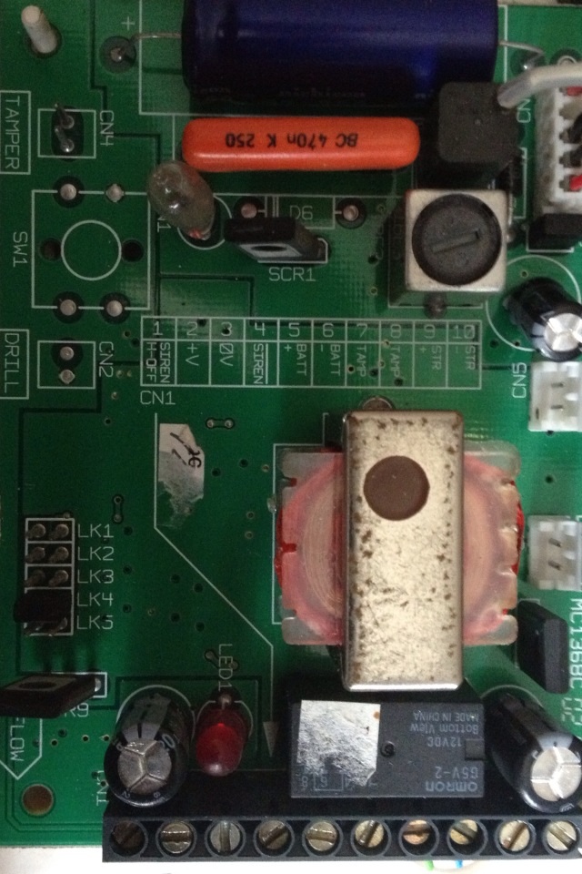

ryan042000 Posted April 13, 2013 Share Posted April 13, 2013 Any one know what the 6 jumpers on a delta 5 do ? Link to comment https://www.thesecurityinstaller.co.uk/community/topic/34359-chubb-delta-5-jumpers/ Share on other sites More sharing options...

ryan042000 Posted April 13, 2013 Author Share Posted April 13, 2013 Looool yeh im startin to think so too your advice today but no luck it just starts up crazy im missing somthing Link to comment https://www.thesecurityinstaller.co.uk/community/topic/34359-chubb-delta-5-jumpers/#findComment-313728 Share on other sites More sharing options...
Lwillis Posted April 13, 2013 Share Posted April 13, 2013 Try powering it with only the +ve feed and -ve hold off applied. All tampers held in ?( lid back wall etc ) See what happens then. Start from basics Link to comment https://www.thesecurityinstaller.co.uk/community/topic/34359-chubb-delta-5-jumpers/#findComment-313730 Share on other sites More sharing options...
ryan042000 Posted April 13, 2013 Author Share Posted April 13, 2013 Nothing hapens the led energises then dies bout a second Wen power applied to 12+ and 0v tamper closed siren energises red and green led turn on Link to comment https://www.thesecurityinstaller.co.uk/community/topic/34359-chubb-delta-5-jumpers/#findComment-313732 Share on other sites More sharing options...
Lwillis Posted April 13, 2013 Share Posted April 13, 2013 Post a picture of the pcb with links and terminals. Link to comment https://www.thesecurityinstaller.co.uk/community/topic/34359-chubb-delta-5-jumpers/#findComment-313738 Share on other sites More sharing options...

ryan042000 Posted April 13, 2013 Author Share Posted April 13, 2013 Jumper 6 is in the top corner Link to comment https://www.thesecurityinstaller.co.uk/community/topic/34359-chubb-delta-5-jumpers/#findComment-313751 Share on other sites More sharing options...
MrHappy Posted April 13, 2013 Share Posted April 13, 2013 With such in depth knowledge you should be mentoring new recruits to the industry . . . I do, & thats why the industry is going down at an alarming rate OP I guess 1-5 timer ? 6 battery link ? but see above Mr Veritas God Link to comment https://www.thesecurityinstaller.co.uk/community/topic/34359-chubb-delta-5-jumpers/#findComment-313774 Share on other sites More sharing options...
