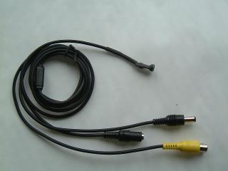

Service Engineer Posted August 27, 2004 Share Posted August 27, 2004 Could you hide this anywhere, wires in the ceiling..? ........................................................ Dave Partridge (Romec Service Engineer) Link to comment https://www.thesecurityinstaller.co.uk/community/topic/3416-bit-of-advice/page/2/#findComment-21789 Share on other sites More sharing options...
Guest Posted August 27, 2004 Share Posted August 27, 2004 Could you hide this anywhere, wires in the ceiling..? 21789[/snapback] I'm sure it could be fitted into something, if I can't find anything that comes in a box I can just screw to the wall then that'd do the job. Link to comment https://www.thesecurityinstaller.co.uk/community/topic/3416-bit-of-advice/page/2/#findComment-21790 Share on other sites More sharing options...
Selsport69 Posted August 27, 2004 Share Posted August 27, 2004 What about an AV mic. CSL & Aritech both do a good looking mic. Bearing in mind most DVRs only have a single channel audio input so if its just the one camera then its fine but no good if multiple cameras. Kev Link to comment https://www.thesecurityinstaller.co.uk/community/topic/3416-bit-of-advice/page/2/#findComment-21806 Share on other sites More sharing options...
