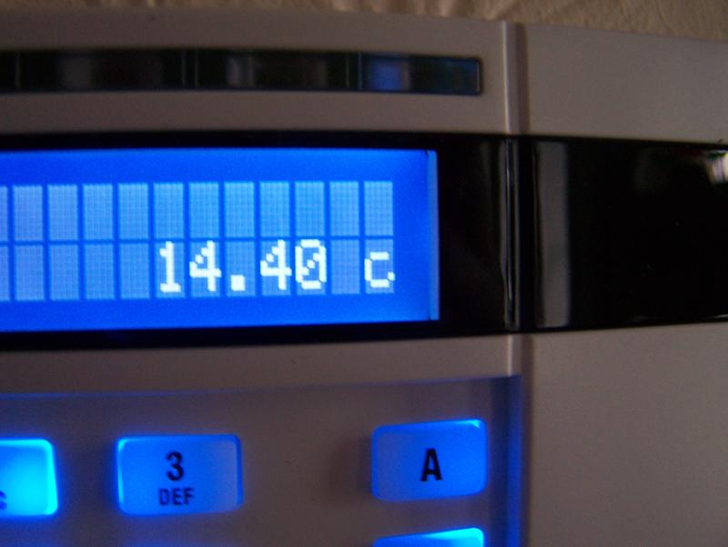

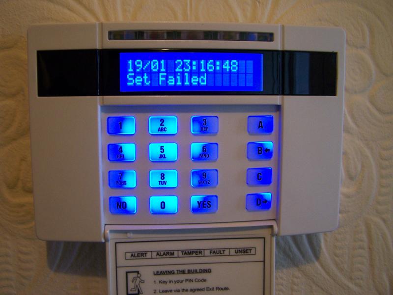

SoupDragon Posted January 20, 2013 Share Posted January 20, 2013 Hi guys, Was looking through the logs on the house alarm (euro mini) and there is a lot of "set failed" however the alarm is setting (logs show when the alarm is unset in the morning). Any ideas as to what this could be? There is also what looks like a "c" on the display when the system is unarmed, it's exactly like the symbol for a closed input. Should it be there? Not sure if that's what is causing set failed but I'm not sure, see pics below. Link to comment https://www.thesecurityinstaller.co.uk/community/topic/33926-set-failed/ Share on other sites More sharing options...
MrHappy Posted January 20, 2013 Share Posted January 20, 2013 c=chime failing to set could be number ff reason why, can you hear the exit tone from outside the final door ? Mr Veritas God Link to comment https://www.thesecurityinstaller.co.uk/community/topic/33926-set-failed/#findComment-301357 Share on other sites More sharing options...
SoupDragon Posted January 20, 2013 Author Share Posted January 20, 2013 c=chimefailing to set could be number ff reason why, can you hear the exit tone from outside the final door ? no chime on any of the inputs, on exit it will say exit via hallway/front door and then carry on counting down until armed. Just tried it and it seems to have all set fine, started counting down when door opened but the logs again say set failed. Link to comment https://www.thesecurityinstaller.co.uk/community/topic/33926-set-failed/#findComment-301358 Share on other sites More sharing options...
MrHappy Posted January 20, 2013 Share Posted January 20, 2013 no chime on any of the inputs, c=chime selected, press c & c will be removed of the display, Mr Veritas God Link to comment https://www.thesecurityinstaller.co.uk/community/topic/33926-set-failed/#findComment-301359 Share on other sites More sharing options...
SoupDragon Posted January 20, 2013 Author Share Posted January 20, 2013 c=chime selected, press c & c will be removed of the display, Doh, thanks Link to comment https://www.thesecurityinstaller.co.uk/community/topic/33926-set-failed/#findComment-301360 Share on other sites More sharing options...
SoupDragon Posted January 20, 2013 Author Share Posted January 20, 2013 Okay I think I've found the problem, on the control panel pcb there was a jumper labled tamper. Linking this has removed the set failed from the logs however the tamper spring for the metal case isn't detected when linked. Link to comment https://www.thesecurityinstaller.co.uk/community/topic/33926-set-failed/#findComment-301362 Share on other sites More sharing options...
james.wilson Posted January 20, 2013 Share Posted January 20, 2013 It won't be relayed to that. What have you got your set fail timer set to? securitywarehouse Security Supplies from Security Warehouse Trade Members please contact us for your TSI vetted trade discount. Link to comment https://www.thesecurityinstaller.co.uk/community/topic/33926-set-failed/#findComment-301378 Share on other sites More sharing options...
SoupDragon Posted January 20, 2013 Author Share Posted January 20, 2013 I'm not sure, how do I check that? Link to comment https://www.thesecurityinstaller.co.uk/community/topic/33926-set-failed/#findComment-301383 Share on other sites More sharing options...
james.wilson Posted January 20, 2013 Share Posted January 20, 2013 Id guess its in the timers menu securitywarehouse Security Supplies from Security Warehouse Trade Members please contact us for your TSI vetted trade discount. Link to comment https://www.thesecurityinstaller.co.uk/community/topic/33926-set-failed/#findComment-301384 Share on other sites More sharing options...
SoupDragon Posted January 20, 2013 Author Share Posted January 20, 2013 I had a look but no mention of a set fail timer or similar, just entry/exit/siren/fire/double knock. Entry/exit is 30 seconds... Link to comment https://www.thesecurityinstaller.co.uk/community/topic/33926-set-failed/#findComment-301391 Share on other sites More sharing options...
