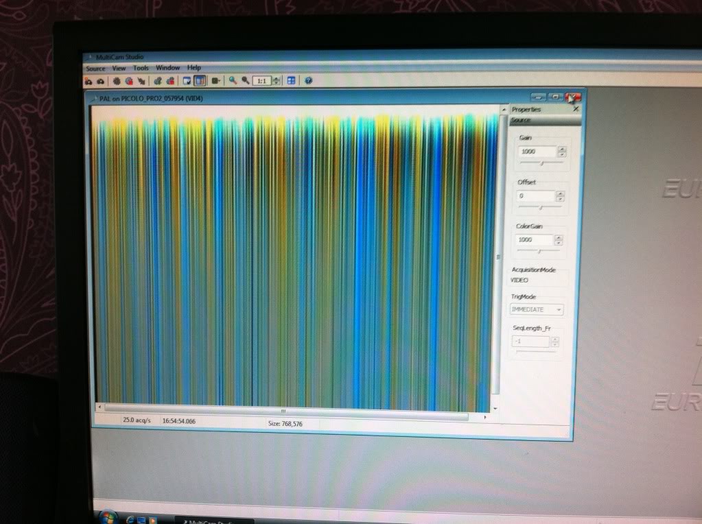

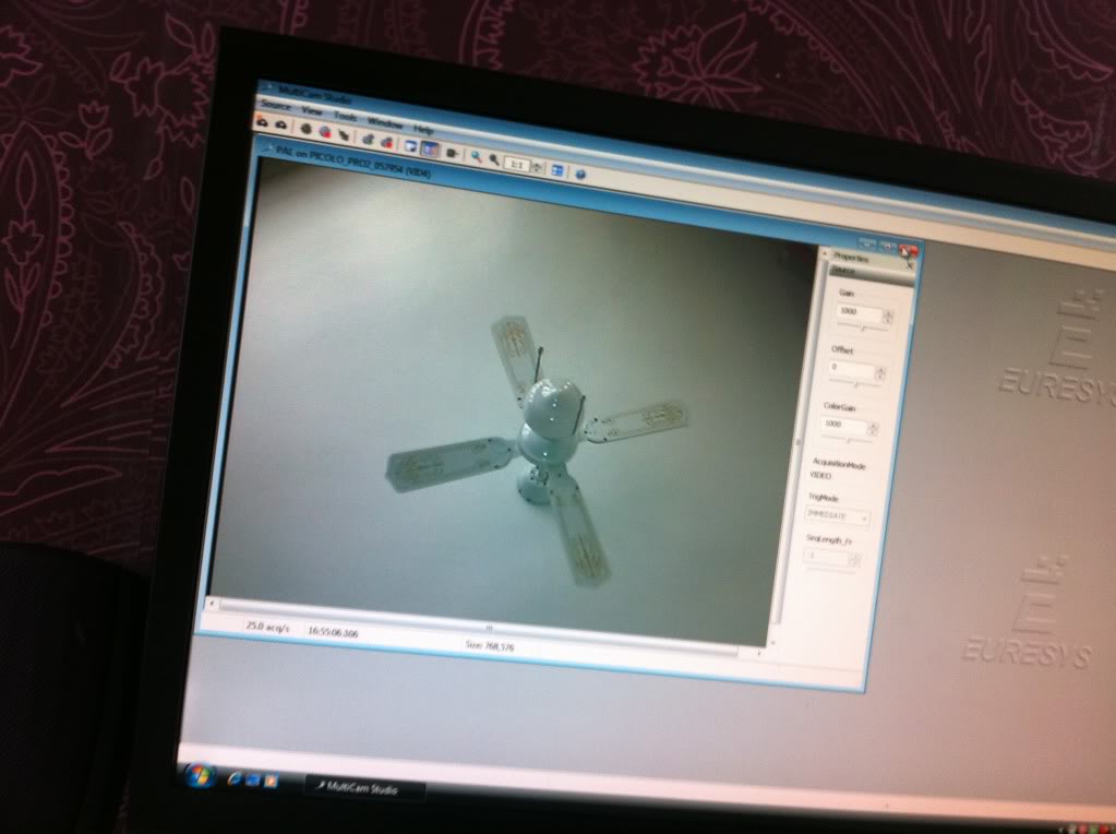

solo Posted May 27, 2011 Share Posted May 27, 2011 Hello everyone Im new to CCTV and was trying out a DIY install when i came across a problem. The camera is an ir camera connected to a picolo pro 2 card in my pc. When i cover the sensor the picture works but during the day, i.e when the sensor detects light it goes fuzzy? Do i have a camera thats not working properly? Pictures attached of problem. Sensor covered sensor open to daylight Hope i have given all the relevant information. Thanks in advance for any help. What seems to be the problem? Link to comment https://www.thesecurityinstaller.co.uk/community/topic/31690-camera-problems-please-help/ Share on other sites More sharing options...

solo Posted May 27, 2011 Author Share Posted May 27, 2011 Sorry for the confusion. The camera has a bnc connection and a power connection. On the front of the camera where the LEDs are their is a little tiny sensor when I cover the sensor with my finger the picture works as in the photo. When I remove my finger and the sensor is exposed to light the picture goes fuzzy. When the camera is put in a dark place and the LEDs activate the image works but when the camera is in daylight the image goes fuzzy see pictures above. Thanks for the help so far. Link to comment https://www.thesecurityinstaller.co.uk/community/topic/31690-camera-problems-please-help/#findComment-274100 Share on other sites More sharing options...
