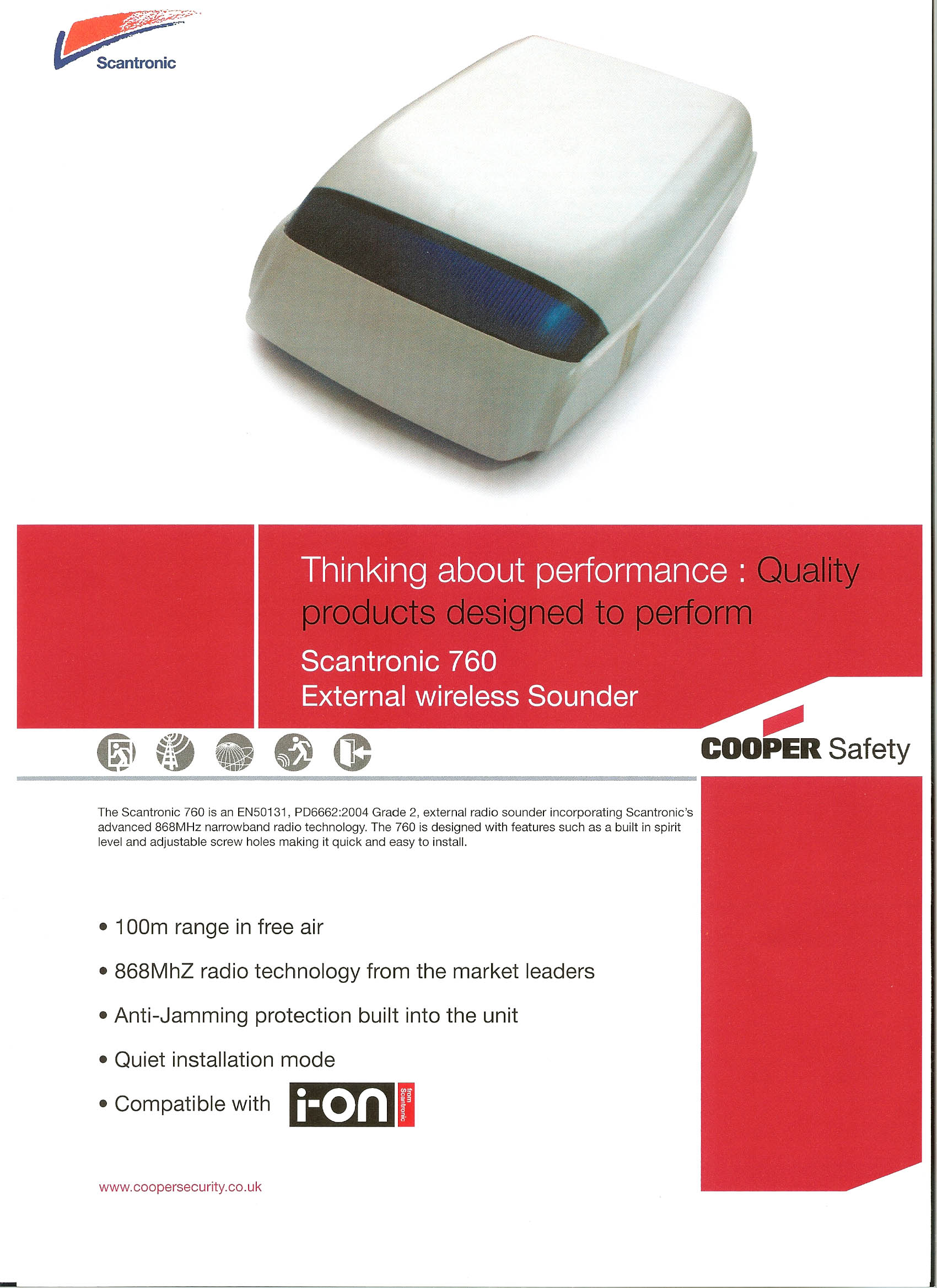

hpotter Posted October 9, 2008 Author Share Posted October 9, 2008 Yer, I'll take some convincing and wont be the first to fit. Bellbox below, not sure about wireless bellboxes though. This one G2, batts last couple of years with 3 x 15min rings a week. Only 105 db, strobe made of LED's. hmm. Link to comment https://www.thesecurityinstaller.co.uk/community/topic/25036-i-on/#findComment-212969 Share on other sites More sharing options...
antinode Posted October 9, 2008 Share Posted October 9, 2008 Looks like this one Trade Member Link to comment https://www.thesecurityinstaller.co.uk/community/topic/25036-i-on/#findComment-212971 Share on other sites More sharing options...
hpotter Posted October 9, 2008 Author Share Posted October 9, 2008 Not the same though. I saw one yesterday, the piezos rear facing as normal but the casing molding sets them back from the rear plate and there's a funnel affect which apparently gives louder output/mA. Link to comment https://www.thesecurityinstaller.co.uk/community/topic/25036-i-on/#findComment-212973 Share on other sites More sharing options...
