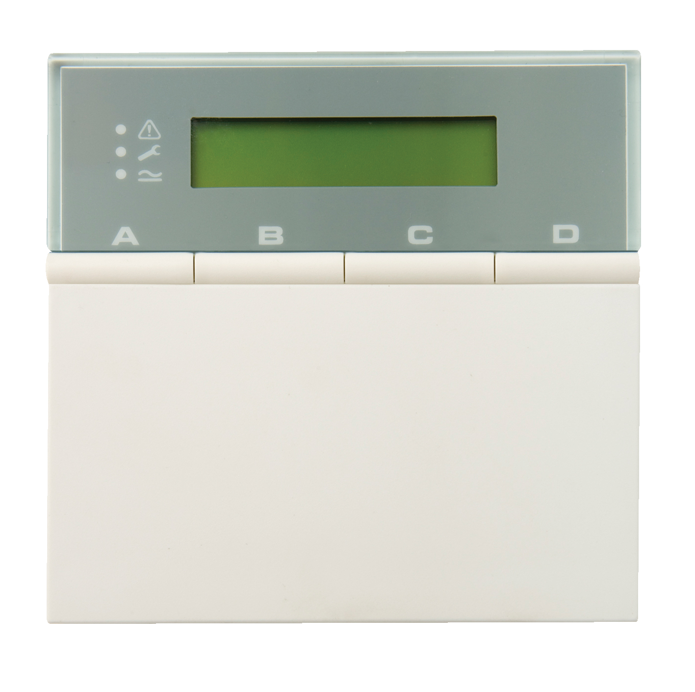

morgan306 Posted October 8, 2008 Share Posted October 8, 2008 In the past I have used a Galaxy and used single button setting. I.e; A=Full Set, B= Part Set. Then just use the fob for disarming. Link to comment https://www.thesecurityinstaller.co.uk/community/topic/25034-simple-panel-for-old-lady-using-simple-prox-rdr/page/2/#findComment-212894 Share on other sites More sharing options...
