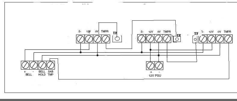

Chorlton Posted September 30, 2008 Share Posted September 30, 2008 Im wanting to connect 3 sounders all in SAB mode, i have an additional power supply. Any one got a wiring diagram? Its a guardtec 350+ panel, guardsound 2 internal sab/scb sounders and 1 external sounder with strobe. Getting back on topic C. Link to comment https://www.thesecurityinstaller.co.uk/community/topic/24901-help-please-3x-sab-sounders/page/2/#findComment-212027 Share on other sites More sharing options...
nobbynobnob Posted September 30, 2008 Author Share Posted September 30, 2008 Sorry for not getting back so quick. I have a couple of sheds side by side, the 350 is already in place with a remote keypad in the house. The plan is to add another 350 keypad in the new shed with 1x sounder external then a guardsound 2 in each shed, to try and keep random scroats out, with shockguards on the doors at the locks as this is what I have in the original shed and has worked well (scroat free) for the last 12 years. Maximum noise for a short period at minmum cost is the aim. Ive had dealings in systems around 12 or so years ago but little since (electrician). What about the the diagram here to get them all in SAB? Link to comment https://www.thesecurityinstaller.co.uk/community/topic/24901-help-please-3x-sab-sounders/page/2/#findComment-212033 Share on other sites More sharing options...
Guest anguscanplay Posted September 30, 2008 Share Posted September 30, 2008 agreed but an sab on the landing aint gonna be so pretty the risco internal sab is a neat unit .......... but i couldnt find a piccy to post. Arf - your argument for NOT having internal sounders, well you might as well not put the fuse in at all then ... arguing for arguings sake IMO What about the the diagram here to get them all in SAB? close - but DONT conenct the 12v between the power pack and the panel, just the 0V power is from the power pack, trigger (switch for you sparkies LOL) is from the panel Link to comment https://www.thesecurityinstaller.co.uk/community/topic/24901-help-please-3x-sab-sounders/page/2/#findComment-212045 Share on other sites More sharing options...
