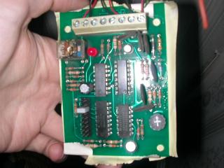

Guest mikeyb Posted March 21, 2004 Share Posted March 21, 2004 led light one zone 2 enters this Link to comment https://www.thesecurityinstaller.co.uk/community/topic/1774-help-please/page/2/#findComment-9805 Share on other sites More sharing options...

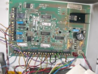

Guest mikeyb Posted March 21, 2004 Share Posted March 21, 2004 and this is the main board thing Link to comment https://www.thesecurityinstaller.co.uk/community/topic/1774-help-please/page/2/#findComment-9806 Share on other sites More sharing options...
morph Posted March 21, 2004 Share Posted March 21, 2004 how did the fault show up? have you checked the fuses? Link to comment https://www.thesecurityinstaller.co.uk/community/topic/1774-help-please/page/2/#findComment-9807 Share on other sites More sharing options...
Guest mikeyb Posted March 21, 2004 Share Posted March 21, 2004 when i cam to arm it for the first time, as it is a new house and the previous owners never used it but gave us the alarm code. no i havent checked the fuses they are both clear glass fuses what do i replace them with? Link to comment https://www.thesecurityinstaller.co.uk/community/topic/1774-help-please/page/2/#findComment-9808 Share on other sites More sharing options...
morph Posted March 21, 2004 Share Posted March 21, 2004 They should have a wire in the middle of both of them very fine. You would probably be better to get a local alarm company in to service it, if you have never known it to work, then i would advise having it checked over. Link to comment https://www.thesecurityinstaller.co.uk/community/topic/1774-help-please/page/2/#findComment-9809 Share on other sites More sharing options...
j.paul Posted March 21, 2004 Share Posted March 21, 2004 There is maybe more than one fault, looks like all the vibo's are on an analyser. Have tried to link out zone 2 and see if the panel sets? jpaul There are no stupid questions, but there are a LOT of inquisitive idiots. Link to comment https://www.thesecurityinstaller.co.uk/community/topic/1774-help-please/page/2/#findComment-9810 Share on other sites More sharing options...
morph Posted March 21, 2004 Share Posted March 21, 2004 In your picture of the keypad there is no power light on. or tamper light on. Link to comment https://www.thesecurityinstaller.co.uk/community/topic/1774-help-please/page/2/#findComment-9811 Share on other sites More sharing options...

.Mike Posted April 14, 2004 Share Posted April 14, 2004 Had this problem before - called back to the customer loads of times linked out tampers etc, check resistance etc and all the usual stuff the problem was still there - turned out to be a faulty panel. Not worth the hassel with the the price of panels today - so I would replace it - eurosec/9448+ good basic choice Link to comment https://www.thesecurityinstaller.co.uk/community/topic/1774-help-please/page/2/#findComment-10879 Share on other sites More sharing options...
