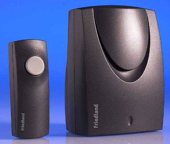

norman Posted January 5, 2007 Share Posted January 5, 2007 Nothing is foolproof to a sufficiently talented fool. Link to comment https://www.thesecurityinstaller.co.uk/community/topic/14866-mechanical-bell-on-bt-line/#findComment-141743 Share on other sites More sharing options...
dpaengineer Posted January 5, 2007 Author Share Posted January 5, 2007 Alarm Guard, I thought it must be something dodgy like that. Norman, for the idea but its a VERY noisy garage, compressors and stuff running. and he wants it to sound when the door is opened. I thought a door contact wired up to something. Just cant find the answer for the something. I've got some electronics knowledge and would have no probs knocking up a timer circuit. Any more ideas? Trade Member Link to comment https://www.thesecurityinstaller.co.uk/community/topic/14866-mechanical-bell-on-bt-line/#findComment-141757 Share on other sites More sharing options...
