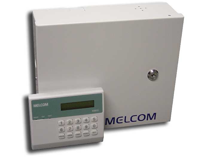

MARKJ124 Posted August 12, 2006 Share Posted August 12, 2006 Hi can somone please help. I have a Melcom ST6100 alarm panel and Melcom K6600 display, the part i need help with is that the when the alarm is NOT armed the display shows the welcome greeting as normal. But after exactly 4 minutes and 17 seconds (yes this is a bit sad i timed it) the day led flashes and the main display shows FAULT. then i have to set the alarm and reset it to get it back to the normal display, then it does the same as above again. The alarm panel does set and work. not had any complaints about a false alarm activation. Anybody have any ideas please. thanks Mark Link to comment https://www.thesecurityinstaller.co.uk/community/topic/11806-melcom-k6600/ Share on other sites More sharing options...

MARKJ124 Posted August 12, 2006 Author Share Posted August 12, 2006 Hi Thanks for the replies. The Melcom system replaced an existing alarm that had been in place for about 8 years (professional fit by a small company). The alarm was installed by myself onto existing wiring but all sensors worked, i have run most of the standard checks the alarm panel will perform e.g walk test, bell test and nothing shows up. The main Melcom ST6100 has a keypad and led status indicators on it, the K6600 is a keyapd with a two line lcd display and led status indicators basically emulates the main unit funtions but with scrolling text. It will quite happily arm and disarm it is only when it is in disarm mode that the day led flashes and the word "fault" shows on the lcd display it will do this every approx 5 minutes if i reset the display by arming the alarm then disarming it again. The alarm is fitted to my parents house they reminded me to take a look at it, i assumed they had been using the alarm but my father had removed the main fuse and it has been powered down for a while but all the programs i had put in were retained in its memory. Sorry if the above is a bit repetitve but i find it bizzare why it waits for an exact amount of time to display the error its like it is stuck in some kind of time loop. Mark Link to comment https://www.thesecurityinstaller.co.uk/community/topic/11806-melcom-k6600/#findComment-111938 Share on other sites More sharing options...
