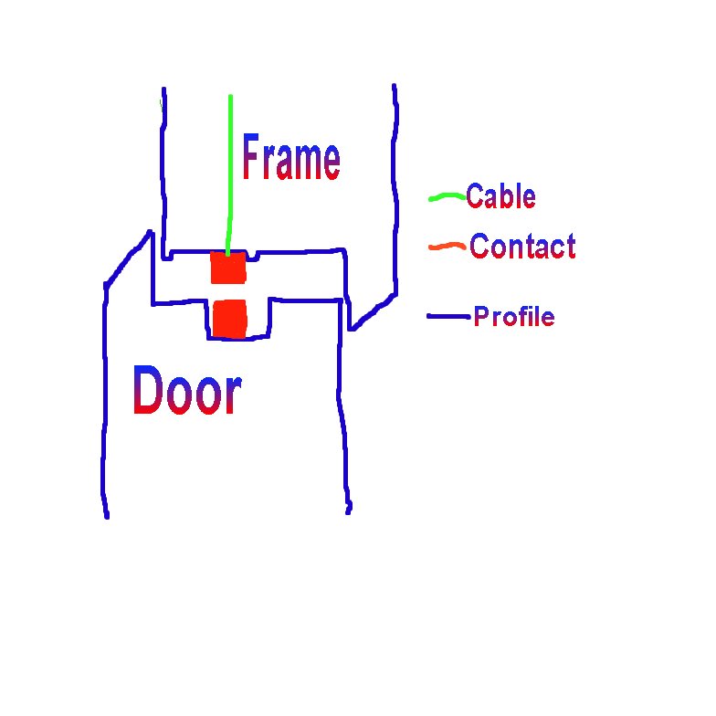

Barsnake Posted April 18, 2006 Share Posted April 18, 2006 This Way Seems To Be The Norm For Us With No Warranty Problems Sorry For Quality and Scale The Magnet Sits Nicely into Where The Locking Section Fits (If It Were On The Side) Only Ever Had A Few That Are To Close For The Contact Itself Sometimes Have To Pack It Up Standard Surface Contact Link to comment https://www.thesecurityinstaller.co.uk/community/topic/10254-pvc-door-contact/#findComment-95698 Share on other sites More sharing options...

Barsnake Posted April 18, 2006 Share Posted April 18, 2006 You are watsed on here, you should be in CAD. Is your keyboard broken ? Yep, that is how we do it. I cannot see how it can effect a warantee. The insulation is not effected. I've Asked At Least A Dozen Different Companies and All Say Its Fine No Problem Link to comment https://www.thesecurityinstaller.co.uk/community/topic/10254-pvc-door-contact/#findComment-95704 Share on other sites More sharing options...
hastings Posted April 18, 2006 Share Posted April 18, 2006 I got properly bollocked by my install manager once for running a cable inside the frame like that, I'm not saying you lot are wrong but I have never done it since then. Customer claimed off our firm for new patio doors cos window firm said warranty was now void. (The problem was condesation in the double glazed unit???). Looks neat to me as well tho, if you do it that way. Link to comment https://www.thesecurityinstaller.co.uk/community/topic/10254-pvc-door-contact/#findComment-95733 Share on other sites More sharing options...
Paul Giles Posted April 19, 2006 Share Posted April 19, 2006 Is that an outward opening door? If so its against NSI standards, correct me if im wrong? PG Security Systems Somerset SSAIB Certificate of Merit Installers. www.pgsecurity.co.uk Link to comment https://www.thesecurityinstaller.co.uk/community/topic/10254-pvc-door-contact/#findComment-95833 Share on other sites More sharing options...
