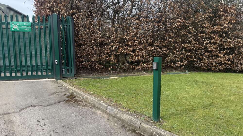

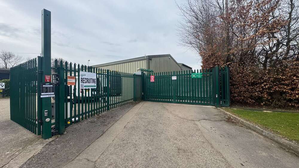

2 gates, main one on the left and the other on the right There are 2 antennas that receive fob inputs

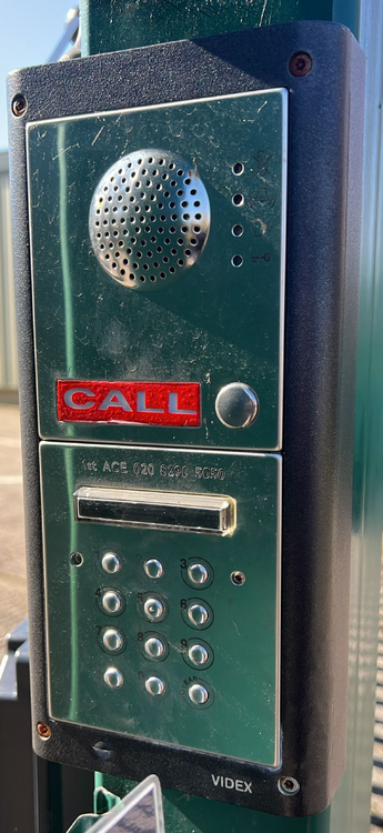

Possible replacement using the newer model as this one appears obsolete https://www.securitywarehouse.co.uk/catalog/access-control-c-27/digital-keypads-c-27_29/videx-4000-series-codelock-module-4901-p-5756.html
Manual looks like this one https://www.videxuk.com/wp-content/uploads/2016/12/66250070-4800-4800M-EN-V1-5.pdf

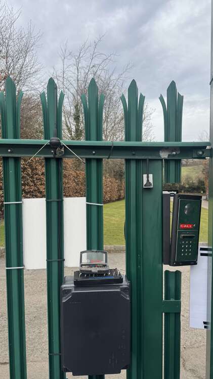

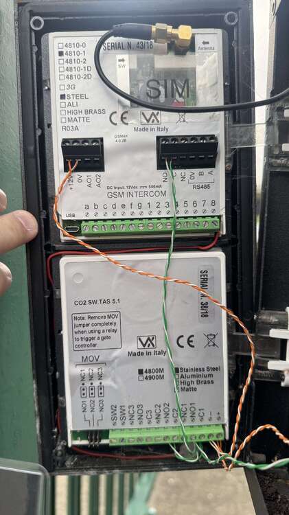

I was wondering if it’s possible to replace a faulty Videx keypad rather than the whole intercom as just 2 of the buttons which are part of the code have worn down over time It’s a GSM model as the customer tells me it calls their mobile phone I’ve attached a photo for reference and any help greatly appreciated I can go there and remove the keypad if an exact model number is needed to look up a suitable replacement

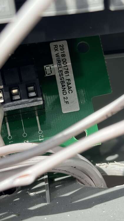

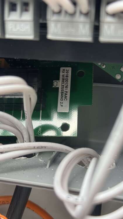

Yeah I think they are using a FAAC one -
Nice branded electric gate controller
jmeader43 replied to jmeader43's topic in !!..DIY Installers..!!
There are 2 aerials but it could be for each gate. I’ll take a photo of this on Friday and check if there is another gate controller or not thanks -

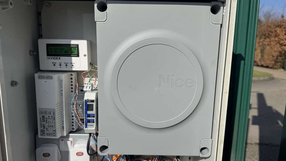

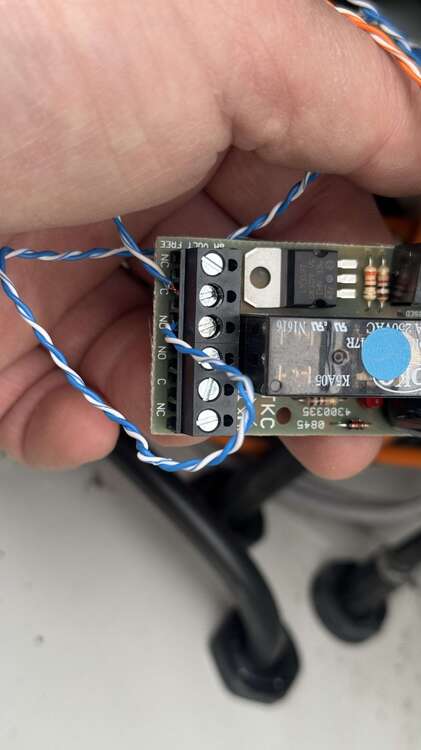

I was thinking to implement a solution I’ve done on another gate recently which I posted on this forum using a WiFi relay called a Shelly Plus 1 which works by any number of users having their app and tapping on a button In addition a replacement keypad so there are 2 methods of opening the gate I think the remotes will end up being expensive as they may need to buy a new kit whereas the Shelly relay is about £18.00 -

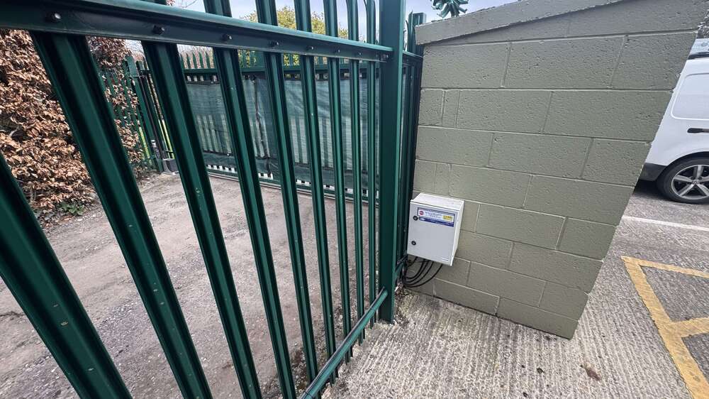

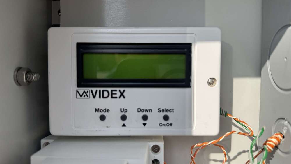

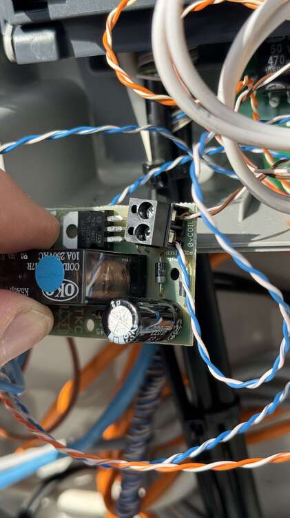

A site I look after is being overcharged each time they request a new remote for their electric gate The controller is a Nice MCA1 I have looked into the possibility of installing a Nice universal receiver that can support low cost remotes if there is such a thing It would also need to support 50+ remotes if possible for all staff and tenants I took some photos if anyone wants to have a look and let me know please. I am having trouble uploading them from my phone at the moment though
