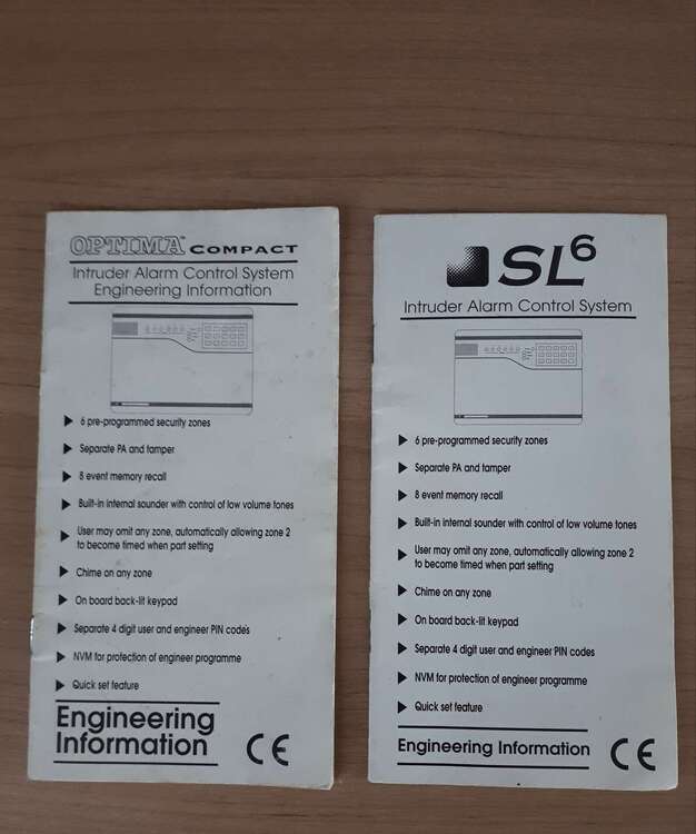

  4. For completeness.. Security Lighting 6 panel is identical to Optima Compact , just a premium rate technical helpline on the back , just a rebrand.
