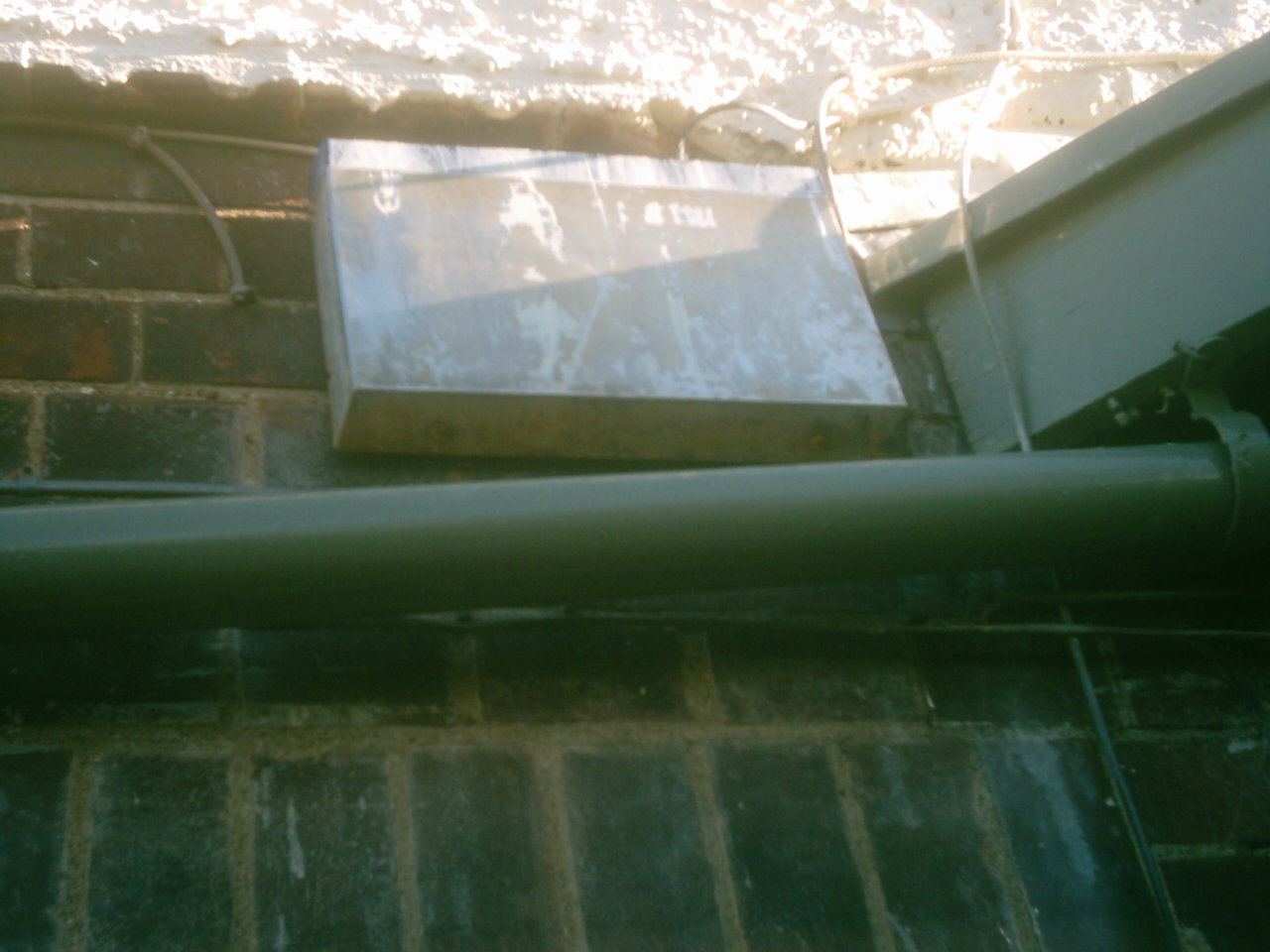

ranger Posted January 21, 2006 Author Share Posted January 21, 2006 Hello again all, I took a few pictures but this is most likely the best one, !! I was at the sounder and i went to unscrew the screws but they were to tight due to rust by the looks of things, and there isnt a lot of space for my drill to undo it. I had the sounder connected at + volts still.. and - at an output.. but when i went to test it.. nothing happened.. but it was exactly how i left it working yesturday. Anyway.. i was at the panel and i removed the plus and negative.. nothing happened... i looked at some of the other cores.. yellow.. blue.. green.. white if i remember correctly. When i realised the yellow and blue were twisted So i untiwsted them.. and all hell broke loose The sounder went off... i reconnected to + & - and also retwisted the yellow and blue.. but nothing would stop it... so i turned the panel off.. and got my multimeter out and the plus and negative read 5.85v, so it has a battery in it.. which must have been charging from when i left it last night perhaps Anyway.. after what seemed ages (maybe it was a 20min shut off.. but it seemed like ages) it just stopped out of the blue.. The plus and negative still read 5.85v and im not sure where to go from here as to not set it off again as it drove the people on site mad. Any help would be great! I dont want to remove the wrong cores again so ive left it for the time being.. All seems odd to me Ranger The above is my personal opinion and not that of my employer or anyone else. Link to comment https://www.thesecurityinstaller.co.uk/community/topic/9013-outside-hornsounder/#findComment-83753 Share on other sites More sharing options...
norman Posted January 21, 2006 Share Posted January 21, 2006 It looks like an old Rapier, disconnect it and forget about it. Nothing is foolproof to a sufficiently talented fool. Link to comment https://www.thesecurityinstaller.co.uk/community/topic/9013-outside-hornsounder/#findComment-83756 Share on other sites More sharing options...
