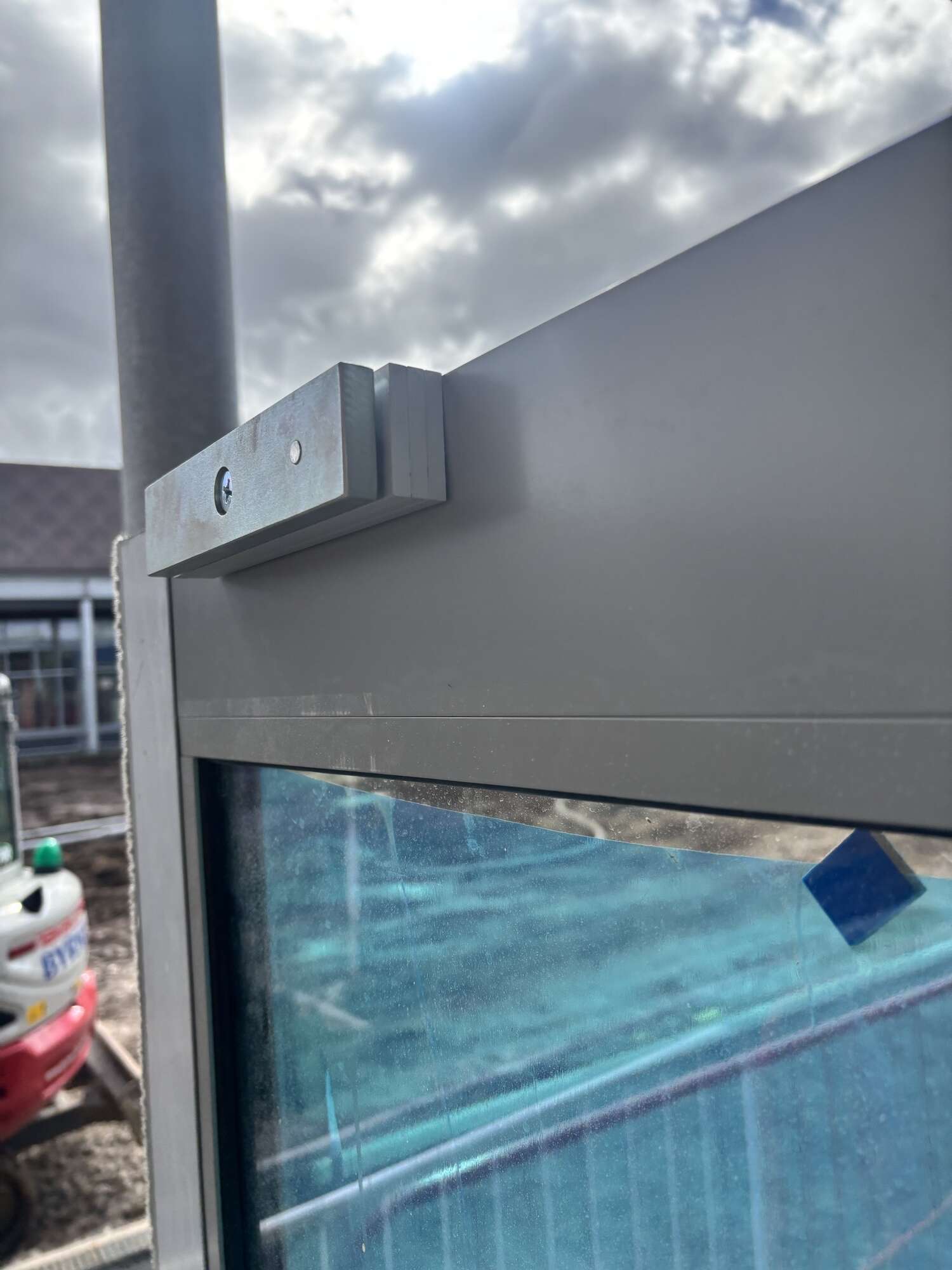

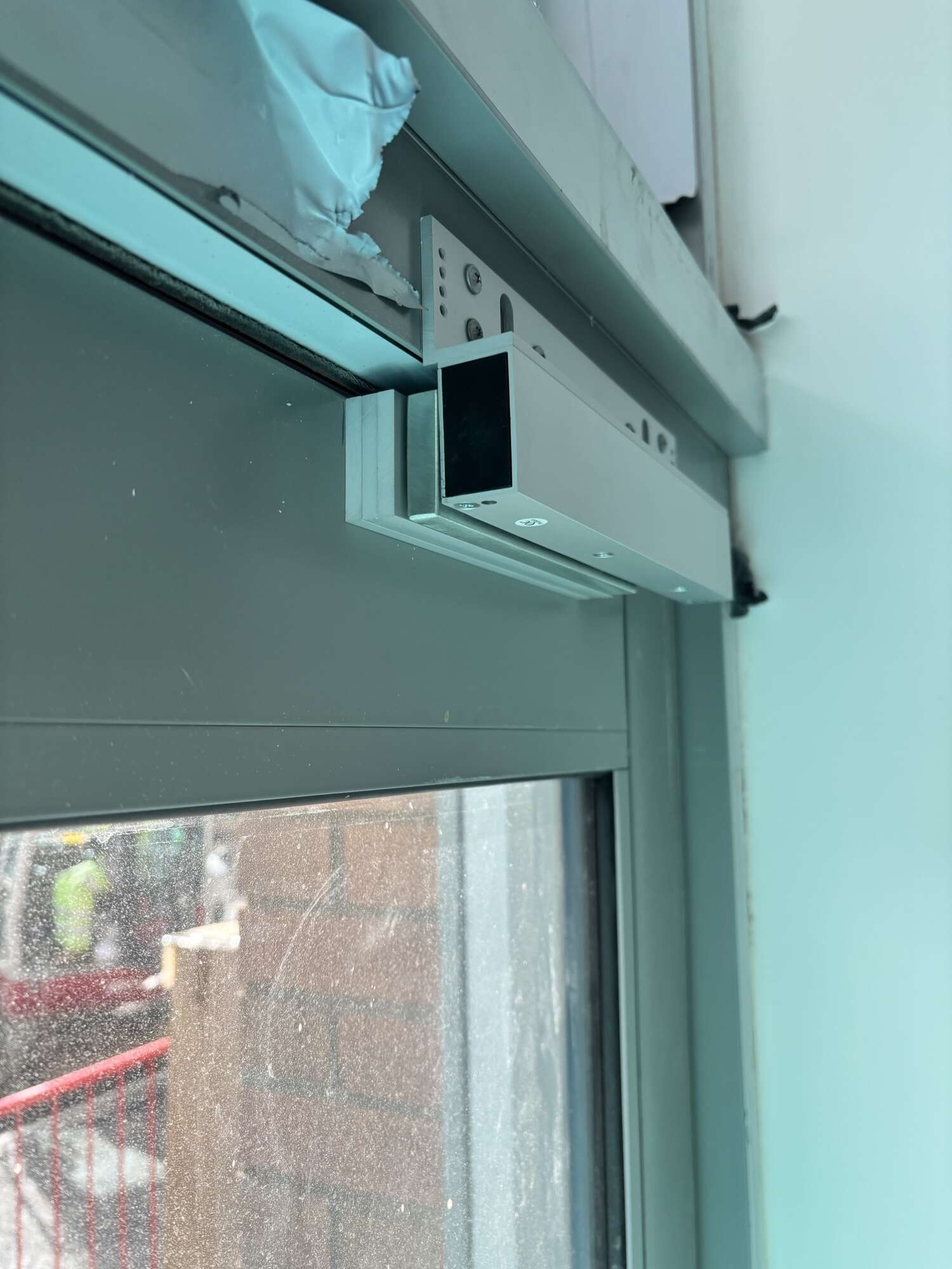

SubbyFS Posted September 22, 2025 Share Posted September 22, 2025 Evening all, can anyone offer any solution to the access control door picture attached? Currently having to use 3 armature plates to pack the magnet out to meet the lock, wondering if anyone has encountered this and if there’s anything on the market to assist? TIA Link to comment https://www.thesecurityinstaller.co.uk/community/topic/47377-outwards-door-access-control-solution/ Share on other sites More sharing options...
james.wilson Posted September 22, 2025 Share Posted September 22, 2025 invert your l bracket 2 securitywarehouse Security Supplies from Security Warehouse Trade Members please contact us for your TSI vetted trade discount. Link to comment https://www.thesecurityinstaller.co.uk/community/topic/47377-outwards-door-access-control-solution/#findComment-530854 Share on other sites More sharing options...
ian.cant Posted September 22, 2025 Share Posted September 22, 2025 https://www.cdvi.co.uk/our-products/300l-adj/ Its adjustable to allow for this situation. Link to comment https://www.thesecurityinstaller.co.uk/community/topic/47377-outwards-door-access-control-solution/#findComment-530855 Share on other sites More sharing options...
sanhaowangluo Posted 16 hours ago Share Posted 16 hours ago Using three armature plates is definitely not ideal for long-term reliability. For outward-opening doors where the magnet doesn't align perfectly with the frame, you should look into a standard Z & L Bracket kit. The 'L' bracket is used to mount the magnet on the header, and the 'Z' bracket allows you to adjust the armature plate to the correct position on the door leaf without needing all those spacers. It’s a much cleaner look and ensures the magnetic pull is consistent across the entire plate. Security System Integrator | Networking & IP Camera Specialist Link to comment https://www.thesecurityinstaller.co.uk/community/topic/47377-outwards-door-access-control-solution/#findComment-531739 Share on other sites More sharing options...
