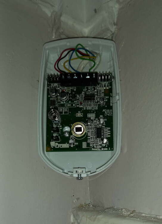

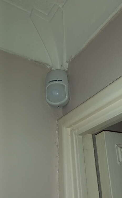

I just disconnected the 12v wires in the box and all was fine when I reconnected them after fitting the new PIRs so I was worrying about nowt really. Just the new one to fit in the garage left to do, and that's for another day - I'm confident I can handle it now though.
Thanks to everyone who replied to my questions - I appreciate the help I've had from this community.
(Edited to add pics)
