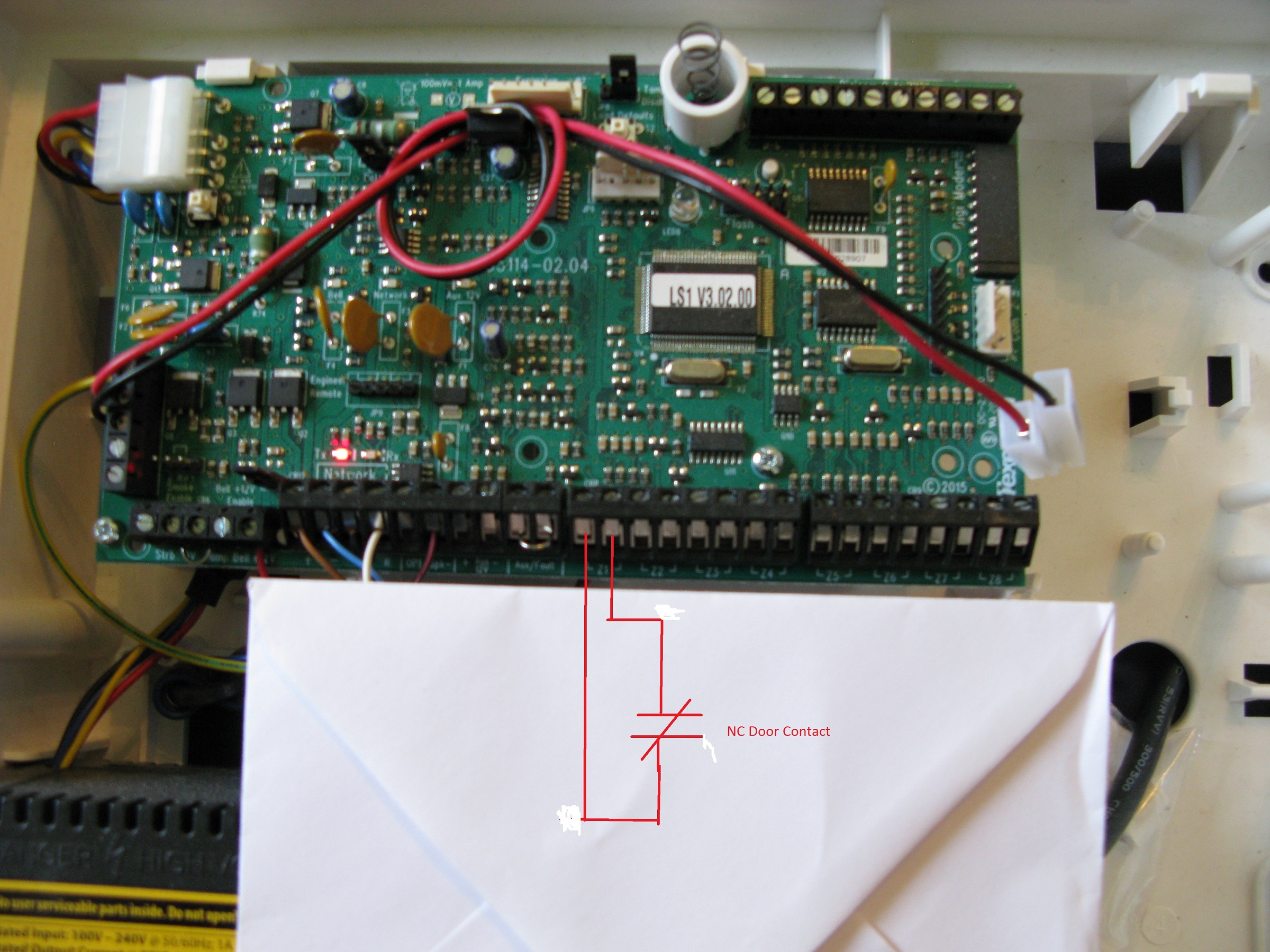

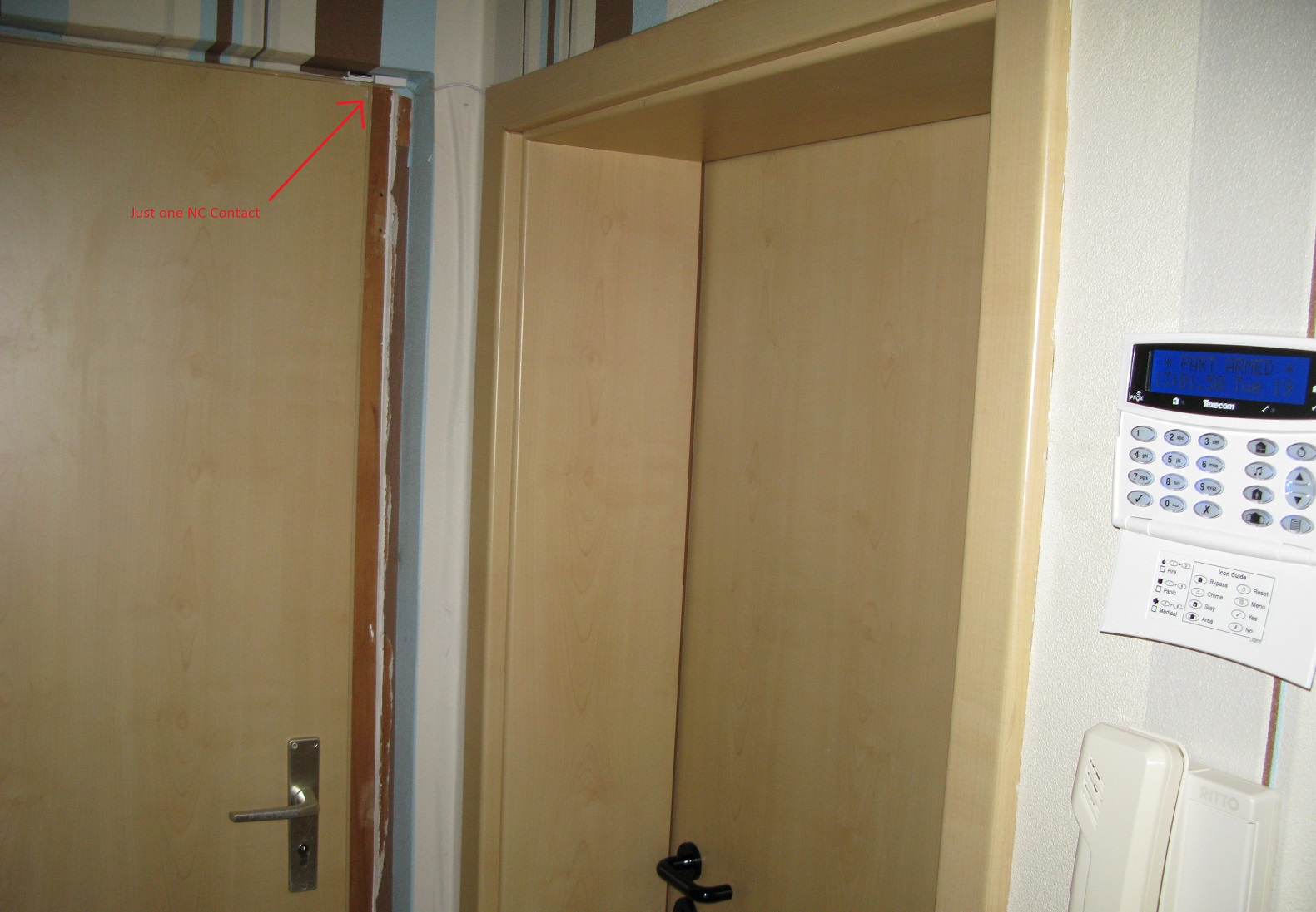

Daniel G Posted August 1, 2017 Share Posted August 1, 2017 (edited) Hallo Can everyone help me with Texecom Premier Elite 24 and LCDLP Blue Keypad. I have just a flat and only one Door to secure. It`s just one NC Contact on Zone 1 connected. How shall I programming the device? And sorry for my bad english. Thank you Best Regards Daniel Edited August 1, 2017 by Daniel G Link to comment https://www.thesecurityinstaller.co.uk/community/topic/41445-texecom-elite-24-programming/ Share on other sites More sharing options...

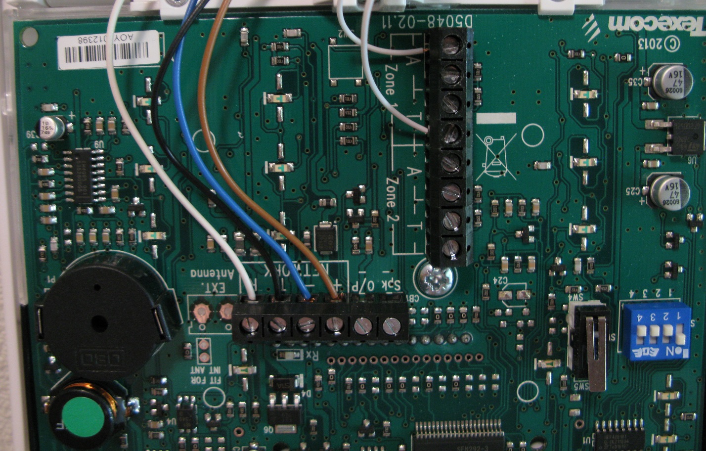

Daniel G Posted August 2, 2017 Author Share Posted August 2, 2017 I have another Question I connect the normally close contact without tamper now on the LCDP Zone 1 Zone Wiring Setting is: Normally Closed The system don't recognize the contact. In Menue View Zone Status also not. How can I activate Zone 1 at the LCDP Or is the wiring wrong? Link to comment https://www.thesecurityinstaller.co.uk/community/topic/41445-texecom-elite-24-programming/#findComment-466813 Share on other sites More sharing options...

sixwheeledbeast Posted August 2, 2017 Share Posted August 2, 2017 Keypad zones have to be mapped. This is Keypad number 1 so Zone 1 on Keypad need mapping to a zone between 1-24. You set the zone wiring type per zone as well. Link to comment https://www.thesecurityinstaller.co.uk/community/topic/41445-texecom-elite-24-programming/#findComment-466815 Share on other sites More sharing options...
sixwheeledbeast Posted August 2, 2017 Share Posted August 2, 2017 You don't need to Link out T just make sure it's programmed as Normally Closed. Link to comment https://www.thesecurityinstaller.co.uk/community/topic/41445-texecom-elite-24-programming/#findComment-466816 Share on other sites More sharing options...
Daniel G Posted August 2, 2017 Author Share Posted August 2, 2017 Thank you for you help!!! The Keypad was not mapped. The system works fine now! Have a nice evening! Daniel Link to comment https://www.thesecurityinstaller.co.uk/community/topic/41445-texecom-elite-24-programming/#findComment-466818 Share on other sites More sharing options...
