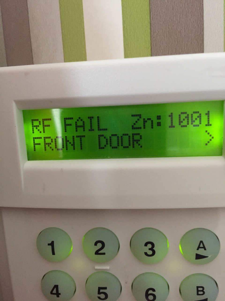

Bigmatt Posted March 11, 2017 Share Posted March 11, 2017 Hi I have a Honeywell galaxy 2-12, C012 Alarm system (ex ADT). My control panel is showing "RF Fail" for all 7 of my detectors, so i had a look at the install manual online and that lead me to check the RF Portal (C079-2) when i check this the red LED is flashing steadily. I guessing this is the issue but just wanted to check, firstly if this is the fault i.e. failed FR portal and secondly does a new RF portal need setting up/pairing or is it just a straight replacement. Thanks in advance, Matt. Link to comment https://www.thesecurityinstaller.co.uk/community/topic/41054-total-rf-failure/ Share on other sites More sharing options...
Nova-Security Posted March 11, 2017 Share Posted March 11, 2017 The Rf Portal should be flashing but depends on the rate 0.1 ON / 0.9 OFF Normal communication OFF No d.c. supply 1.5 ON / 1.5 OFF RIO has not been configured into system 0.2 ON / 0.2 OFF RIO has lost communication with system 0.9 ON / 0.1 Very poor communications If you have access to the programming menu check RF module comms in 61-3 www.nova-security.co.uk www.nsiapproved.co.uk No PMs please unless i know you or you are using this board with your proper name. Link to comment https://www.thesecurityinstaller.co.uk/community/topic/41054-total-rf-failure/#findComment-460239 Share on other sites More sharing options...
GalaxyGuy Posted March 11, 2017 Share Posted March 11, 2017 Module probably needs power cycled. I've seen this happen, but quite rare. If not under contract and you have engineering code, it's easier to power cycle the whole system (batt and mains disconnect momentarily), then correct the time and date. Link to comment https://www.thesecurityinstaller.co.uk/community/topic/41054-total-rf-failure/#findComment-460240 Share on other sites More sharing options...
Bigmatt Posted March 19, 2017 Author Share Posted March 19, 2017 Thanks Galaxy Guy this did the trick just need to reset the date and time any ideas Link to comment https://www.thesecurityinstaller.co.uk/community/topic/41054-total-rf-failure/#findComment-460534 Share on other sites More sharing options...
andy82 Posted March 19, 2017 Share Posted March 19, 2017 3 hours ago, Bigmatt said: Thanks Galaxy Guy this did the trick just need to reset the date and time any ideas From managers menu option 41 Link to comment https://www.thesecurityinstaller.co.uk/community/topic/41054-total-rf-failure/#findComment-460540 Share on other sites More sharing options...
