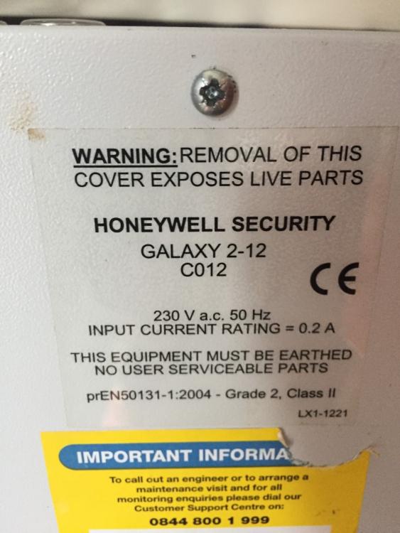

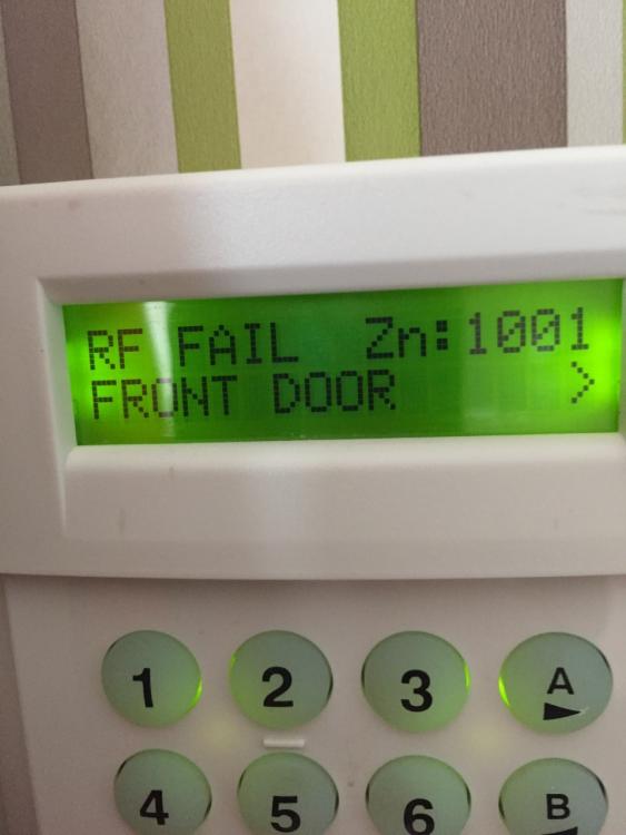

  2. Hi I have a Honeywell galaxy 2-12, C012 Alarm system (ex ADT). My control panel is showing "RF Fail" for all 7 of my detectors, so i had a look at the install manual online and that lead me to check the RF Portal (C079-2) when i check this the red LED is flashing steadily. I guessing this is the issue but just wanted to check, firstly if this is the fault i.e. failed FR portal and secondly does a new RF portal need setting up/pairing or is it just a straight replacement. Thanks in advance, Matt.
