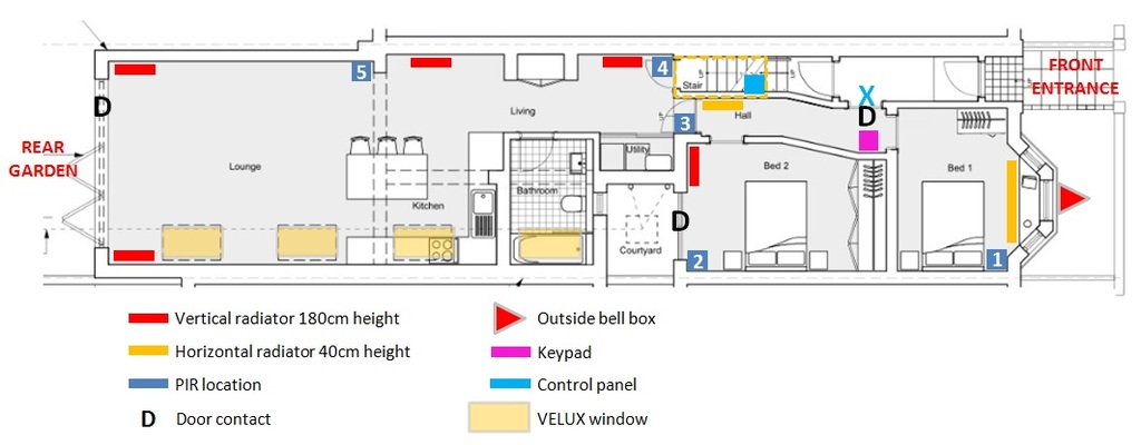

MarkJohnson Posted January 24, 2017 Author Share Posted January 24, 2017 (edited) One more question...is it worth having a PIR sensor in the top left corner of the hallway (right above / next to entrance to bedroom 2), looking at the keypad (location 3), as at the moment, the only thing protecting the keypad is the door contact sensor on main door to the flat...if somebody manages to defeat it / it malfunctions, the keypad isn't guarded as it were. Is this a necessary addition or am I overloading / overdoing it? Location 3, below... Edited January 24, 2017 by MarkJohnson Link to comment https://www.thesecurityinstaller.co.uk/community/topic/40744-informal-advice-on-pir-positioning/page/3/#findComment-457353 Share on other sites More sharing options...
datadiffusion Posted January 24, 2017 Share Posted January 24, 2017 Nope, wouldn't worry 1 So, I've decided to take my work back underground.... to stop it falling into the wrong hands Link to comment https://www.thesecurityinstaller.co.uk/community/topic/40744-informal-advice-on-pir-positioning/page/3/#findComment-457354 Share on other sites More sharing options...
MarkJohnson Posted January 24, 2017 Author Share Posted January 24, 2017 (edited) Do you mean not to worry as in, "yes, add a sensor there" or don't worry as in "don't add sensor 3, it will be fine without it." Which type of worry is it? Edited January 24, 2017 by MarkJohnson Link to comment https://www.thesecurityinstaller.co.uk/community/topic/40744-informal-advice-on-pir-positioning/page/3/#findComment-457355 Share on other sites More sharing options...
datadiffusion Posted January 24, 2017 Share Posted January 24, 2017 Don't add another sensor 1 So, I've decided to take my work back underground.... to stop it falling into the wrong hands Link to comment https://www.thesecurityinstaller.co.uk/community/topic/40744-informal-advice-on-pir-positioning/page/3/#findComment-457356 Share on other sites More sharing options...
MarkJohnson Posted January 24, 2017 Author Share Posted January 24, 2017 (edited) Got it. I guess it's one of those less is more situations! Out of interest, notwithstanding the wall and that it faces into the living room, wouldn't sensor 4 be able to pick up something if the door to the flat door is flung open? Edited January 24, 2017 by MarkJohnson Link to comment https://www.thesecurityinstaller.co.uk/community/topic/40744-informal-advice-on-pir-positioning/page/3/#findComment-457357 Share on other sites More sharing options...
datadiffusion Posted January 24, 2017 Share Posted January 24, 2017 Nope, it really shouldn't, but I still wouldn't worry about it. There is nothing that can be done to defeat the alarm from the keypad and they will have to either take things from the hallway only or proceed to any room setting off the sensor anyway 1 So, I've decided to take my work back underground.... to stop it falling into the wrong hands Link to comment https://www.thesecurityinstaller.co.uk/community/topic/40744-informal-advice-on-pir-positioning/page/3/#findComment-457359 Share on other sites More sharing options...
