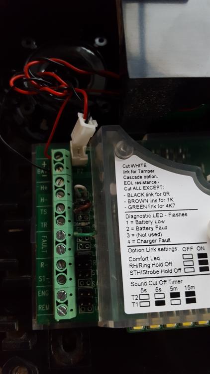

I have a Eurosec control panel and I am wiring up a new alarm box. The alarm box has Cut White wire for Tamper Cascade options. EOL Resistance Cut All Except Black link or Brown for 1K Green for 4K7. Do I need to cut any wires?

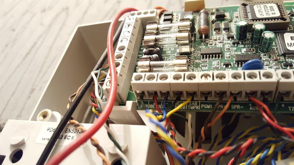

I believe this is my manual for my control panel
Read more:link removed
Model of alarm box Elmdene 7442 G3F
If I have no wires cut the alarm bell keeps going off and on the keypad it displays alarm bell Box tamper..

control box photo

The instructions state;
Cut WHITE link to cascade (i.e more than one live bellbox). I'm assuming not, so LEAVE the white link.
It then states...
Cut ALL except...
So presuming you want a negative tamper return, for the panel you're using, you DO need to cut the BROWN and GREEN links.
tired that but doesn't work. when the tamper goes off the siren goes off but even if you reset the alarm panel and tamper swtich the siren still goes off.

eurosec is neg tamper return, will need a neg feed to TS

As above, assumed you'd fed neg to TS already...
