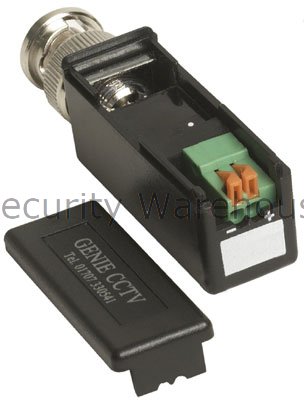

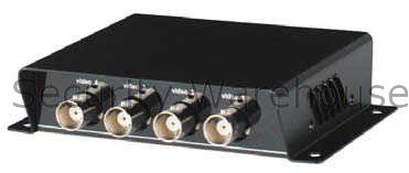

EggyBum69 Posted February 5, 2014 Author Share Posted February 5, 2014 james my order is nearly finished just need to make sure you can use these at the dvr end http://www.securitywarehouse.co.uk/catalog/index.php?main_page=product_info&products_id=1510 with these at the camera end http://www.securitywarehouse.co.uk/catalog/index.php?main_page=product_info&products_id=1509 if so ive got everything i need in the cart an its check out time Link to comment https://www.thesecurityinstaller.co.uk/community/topic/36087-secware-eco-960h-4-channel-dvr-max-hdd-size/#findComment-366794 Share on other sites More sharing options...
datadiffusion Posted February 5, 2014 Share Posted February 5, 2014 I'm not James (obv!) but I say yes because you just need 4 x BNC leads to connect to the dvr. So, I've decided to take my work back underground.... to stop it falling into the wrong hands Link to comment https://www.thesecurityinstaller.co.uk/community/topic/36087-secware-eco-960h-4-channel-dvr-max-hdd-size/#findComment-366797 Share on other sites More sharing options...
james.wilson Posted February 5, 2014 Share Posted February 5, 2014 Yeah should be fine. Just don't mix and match baluns from different manufacturers. Also if you ever plan on upgrading to hdsdi then you will need coax. securitywarehouse Security Supplies from Security Warehouse Trade Members please contact us for your TSI vetted trade discount. Link to comment https://www.thesecurityinstaller.co.uk/community/topic/36087-secware-eco-960h-4-channel-dvr-max-hdd-size/#findComment-366798 Share on other sites More sharing options...
