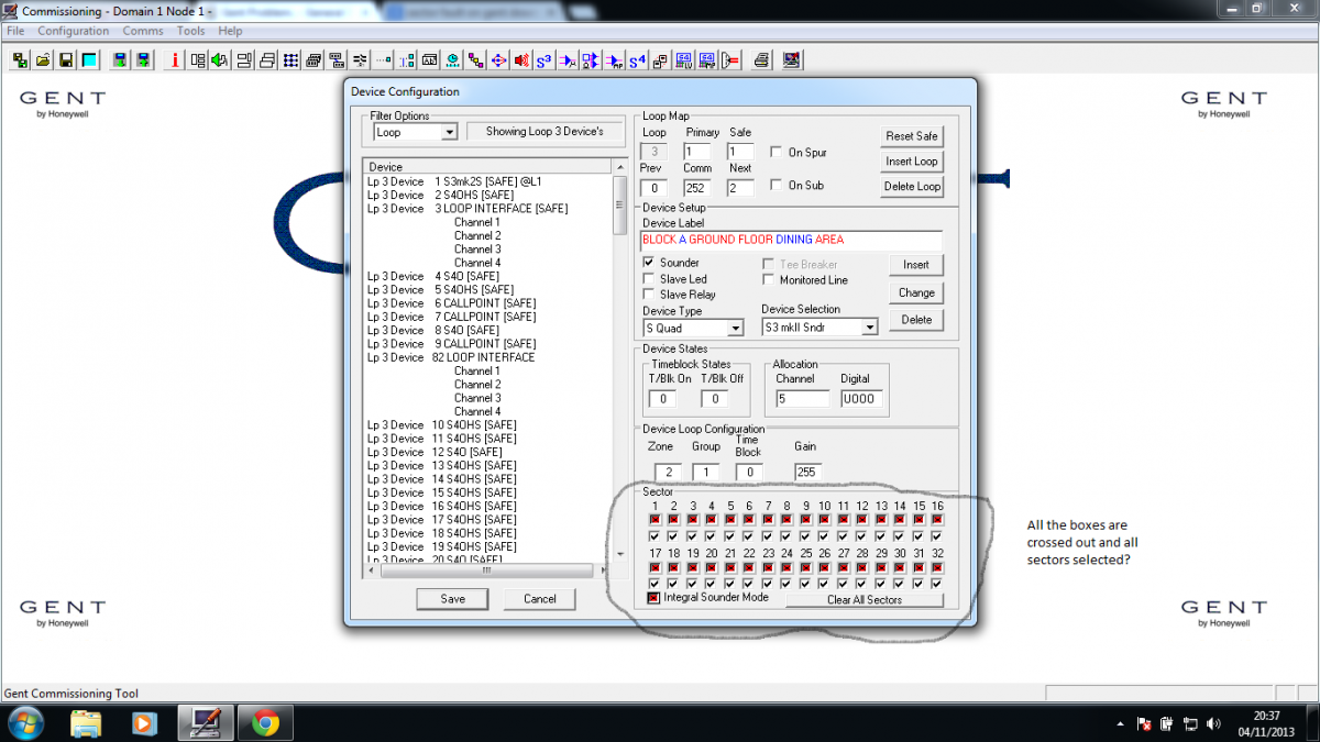

Chopper81 Posted November 4, 2013 Share Posted November 4, 2013 Hi, Engineer from the NW here. 7 years experience with all kinds of Fire and Security systems. Ive held roles in both install, commision, service and maintenance and planning.Im quite a capable engineer and usually the guy the other engineers end up calling but I just cant get my head round this problem im having with the Gent Vigilon. Dont get me wrong I love Gent systems I find them very Engineer friendly and I can get a lot of info from the panel for over the phone diagnoses, its by far my favourite choice of panel. Just recently though this has happened to me twice. I take a download and one of the loops Sector selection area under device config will be all red X'd out. I called tech support and they talked me through resetting it. Its happened to me again and guess what I didnt write down what to do. Does anyone know the cause of the fault as I dont think im doing a lot wrong im not disabling sectors and backing up or anything like that.I think the fix last time was MENU-CONTROL-ENABLE-SOUNDER-LOOP (1-6)Snd Grp 2-ENTER. Can anyone clarify this? in advance. Link to comment https://www.thesecurityinstaller.co.uk/community/topic/35580-gent-bug/ Share on other sites More sharing options...
Chopper81 Posted November 4, 2013 Author Share Posted November 4, 2013 Hi guys, Had a problem with a Gent vigilon 6 loop panel. Ive worked with Gent for a while now and never come across this before. I retrieve config and any loop can have the Sector selection part instead of green boxes tey will be red boxes with black ticks. This first happened the other night and gent told me how to fix it I think they said MENU - CONTROL - SOUNDER - LOOP (1-4) - Snd Grp 2 - ENTER.Has anyone else happened to come across this fault? If so what is causing it? and whats the fix?? Any help will be appreciated.Thanks Link to comment https://www.thesecurityinstaller.co.uk/community/topic/35580-gent-bug/#findComment-353028 Share on other sites More sharing options...
Chopper81 Posted November 4, 2013 Author Share Posted November 4, 2013 I hope that makes it clearer. Link to comment https://www.thesecurityinstaller.co.uk/community/topic/35580-gent-bug/#findComment-353029 Share on other sites More sharing options...
Chopper81 Posted November 4, 2013 Author Share Posted November 4, 2013 It looks like this??? Link to comment https://www.thesecurityinstaller.co.uk/community/topic/35580-gent-bug/#findComment-353030 Share on other sites More sharing options...
