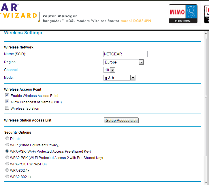

skywalker Posted July 16, 2013 Share Posted July 16, 2013 Get one that supports extended service set, so you can increase range seamlessly( if it doesnt, your device will need to renew its ip every time it changes ap) this is what i need. i don't know a lot about networks and tried using two identical routers with the same wireless settings. the devices would switch from one to the other, but the connection was proper iffy! so, got any recommendations? Link to comment https://www.thesecurityinstaller.co.uk/community/topic/34954-access-point/page/2/#findComment-333371 Share on other sites More sharing options...

skywalker Posted July 17, 2013 Share Posted July 17, 2013 thanks for the help.doesn't look like my netgear can support it unfortunately but i do have a stack of old routers which i can try now i know what i'm looking for!regarding channels, should they both be the same? or sequential (i.e 9,10), or does it not matter as long as they're not the same? Link to comment https://www.thesecurityinstaller.co.uk/community/topic/34954-access-point/page/2/#findComment-333534 Share on other sites More sharing options...
