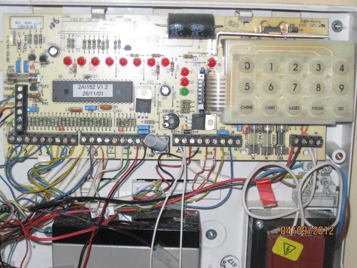

dazzerd Posted September 4, 2012 Author Share Posted September 4, 2012 Hi thanks for that. Just managed to get photo of PCB and attach it. Dates say 2001 so suspect its a G3? Looks like i'm going to be be buying a G4 and swapping out the PCB. Might go for the Accenta mini rather than Compact as its cheaper and gives me communicator connectivity would be useful for dialer. Link to comment https://www.thesecurityinstaller.co.uk/community/topic/33348-accenta-g4-rkp-f131-01-111-on-display/#findComment-289479 Share on other sites More sharing options...
